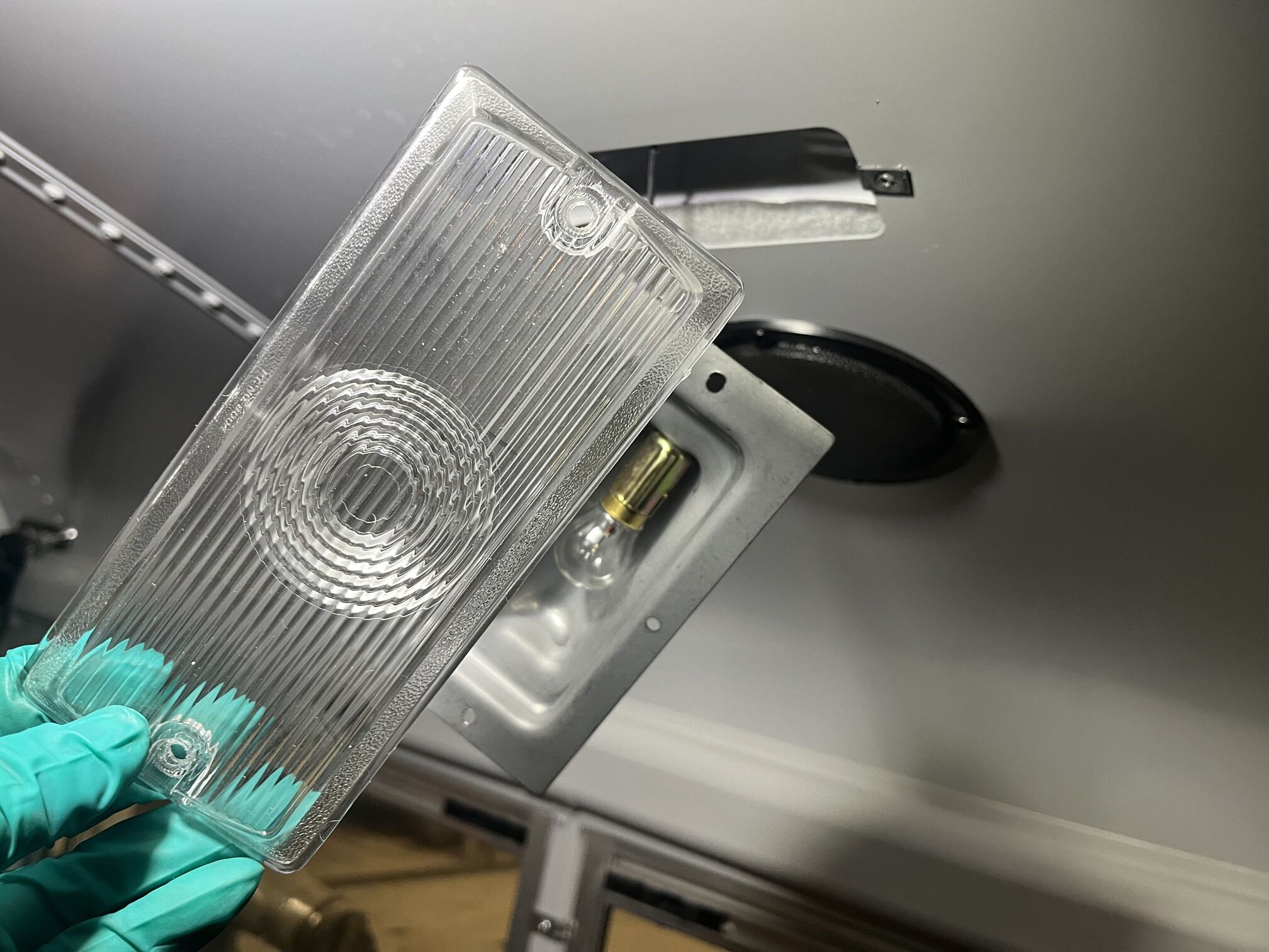

Thomas mini bus interior passenger left side light out.
Remove the light cover

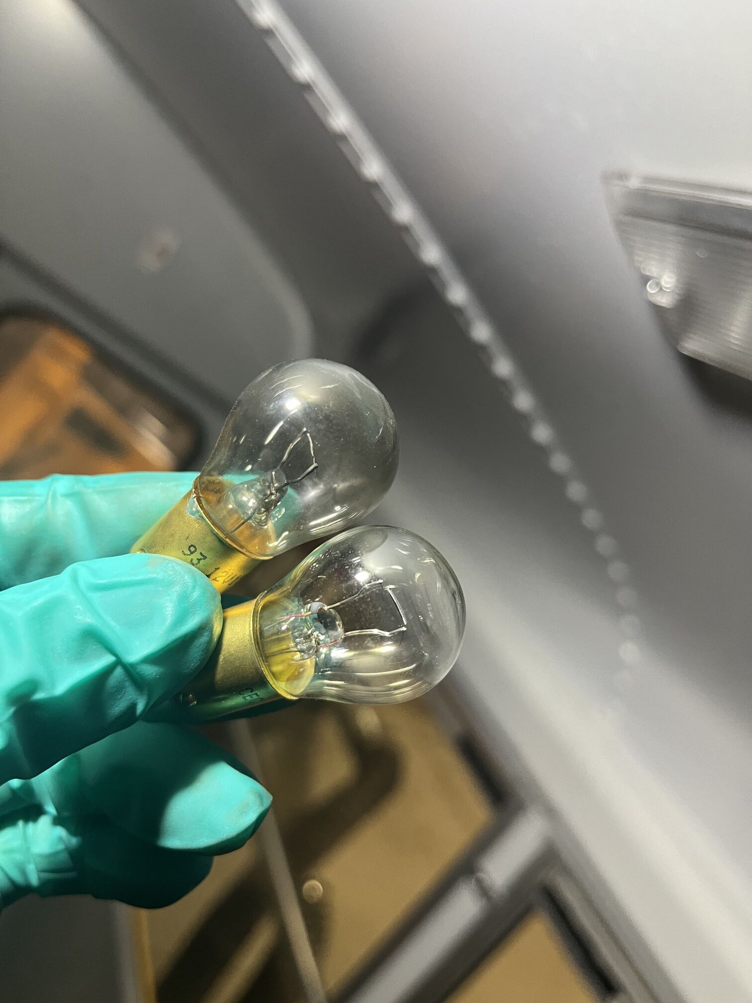

Remove the bulb. Compare new(right) and old(left) bulb. Bulb looks more black. Damaged bulb.
Only one wire to the light assembly. Grounding throng the screw to the body.
Replace with new bulb.
Test. Good
