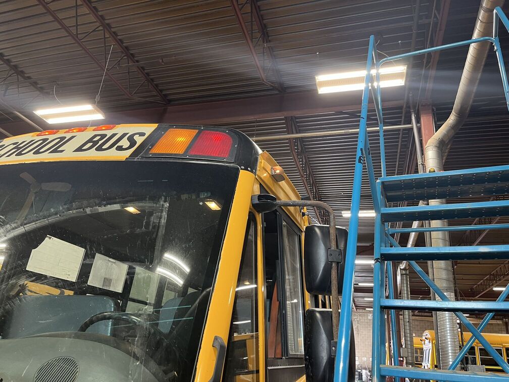

Thomas bus left front top clearance light not working

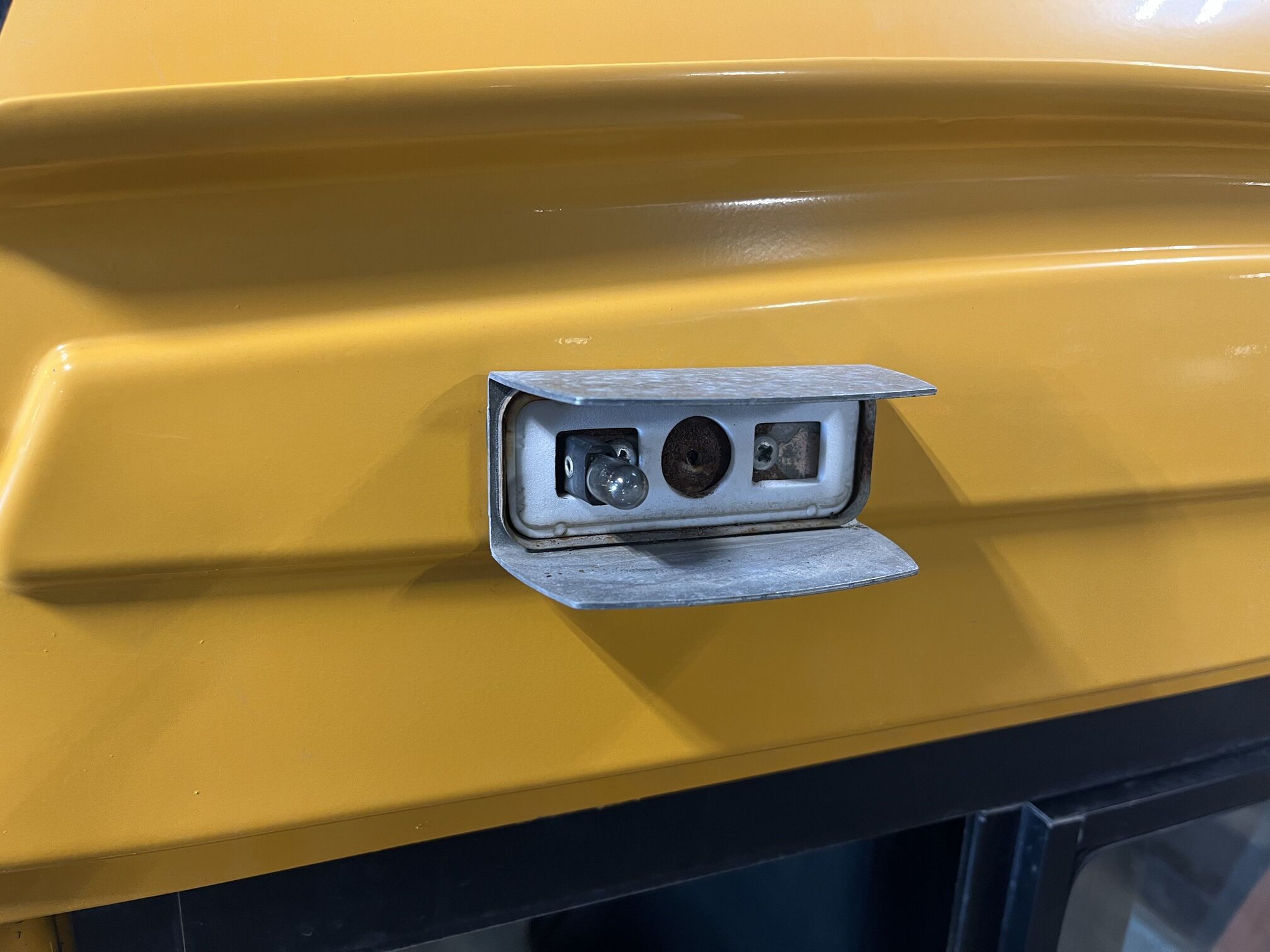

  1. Remove the cover of clearance light
  2. The bulb looks black. Bulb is damaged.

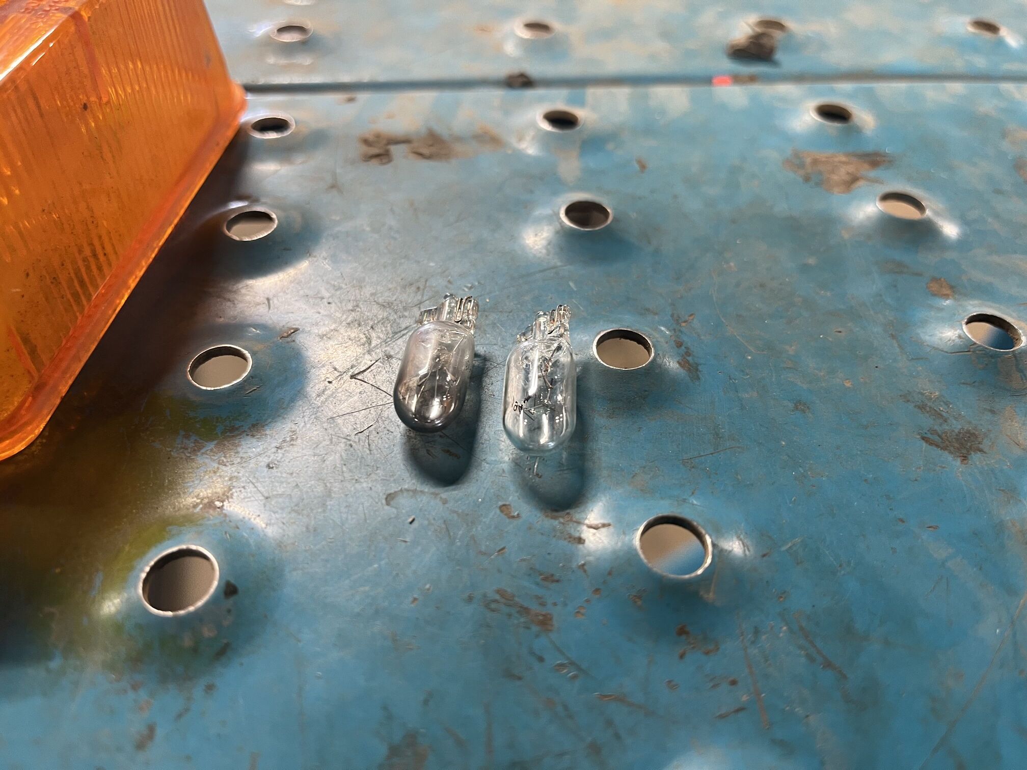

  3. Remove the bulb, compare to a new one. Left is old, right is new.

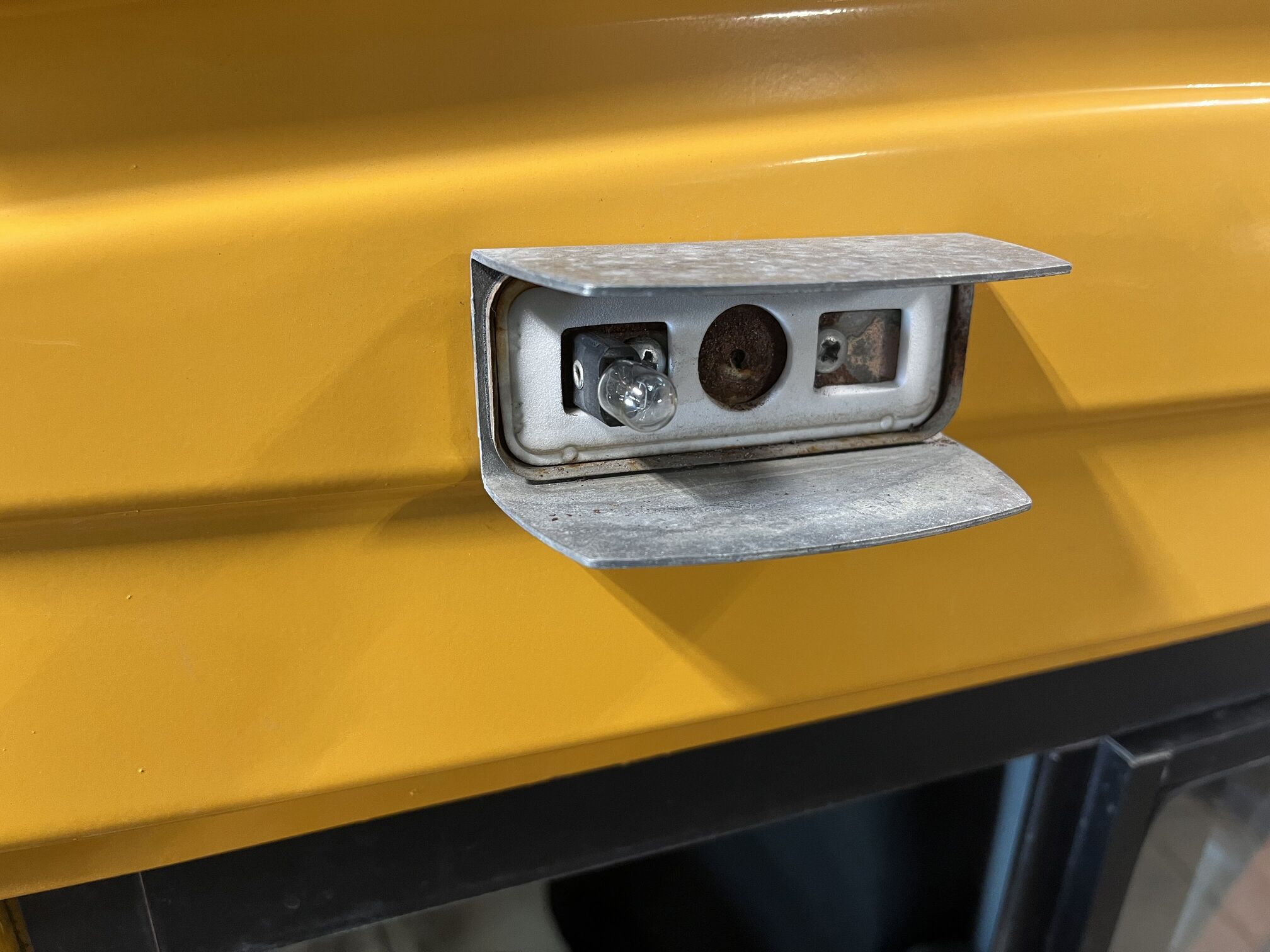

  4. Put new bulb in
  5. Test good

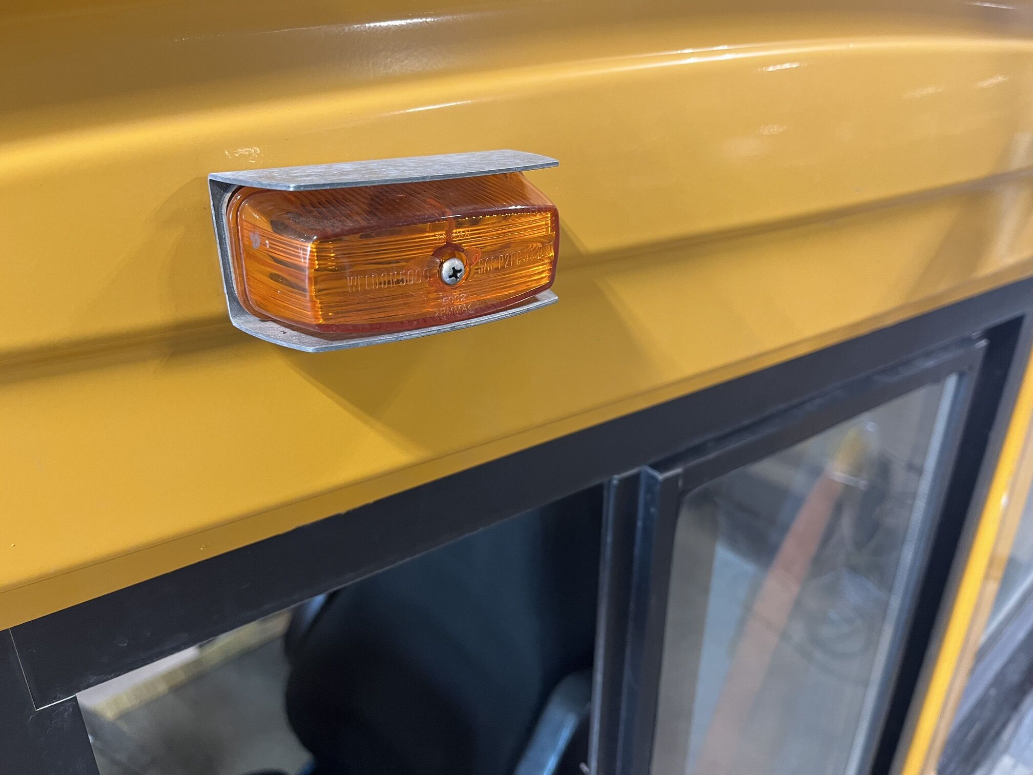

  6. Reinstall the cover
