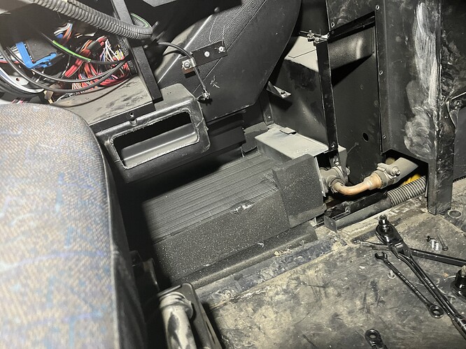

  2. Try to check the blower side power supply.
  3. Remove the cover of the heater blower.
  4. Take out the blower.

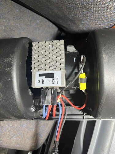

  5. There is a resistor on the top the blower. 3 pins, two red, one blue, blue lower power, mid red high power, out side red out put to the blower positive.
  6. The switch on the lower position. There is power on blue wire but no power on the outside output red wire. No power on the high.
  7. The switch on the high position. There is power on the two red wires also on the lower blue wire.
  8. The resistor broken. parts ordered.
  9. R&R new resistor. Test good.
  10. Reinstall the blower.
  11. Reinstall the cover.
