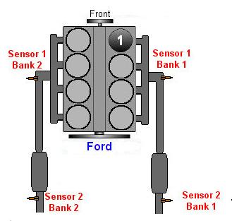

p0155 - 02 sensor heater bank 2 sensor 1

  • Location:
Bank 2 refers to the side of the engine opposite of Bank 1 (often cylinder number 2), and Sensor 1 is usually the upstream oxygen sensor, located before the catalytic converter.
