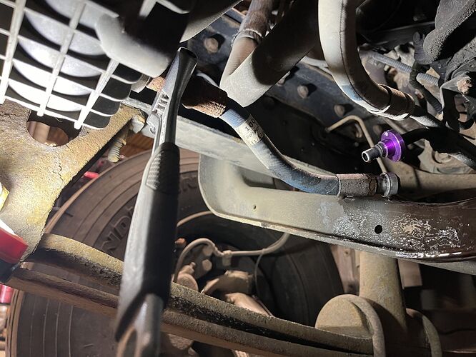

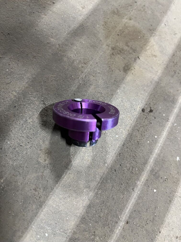

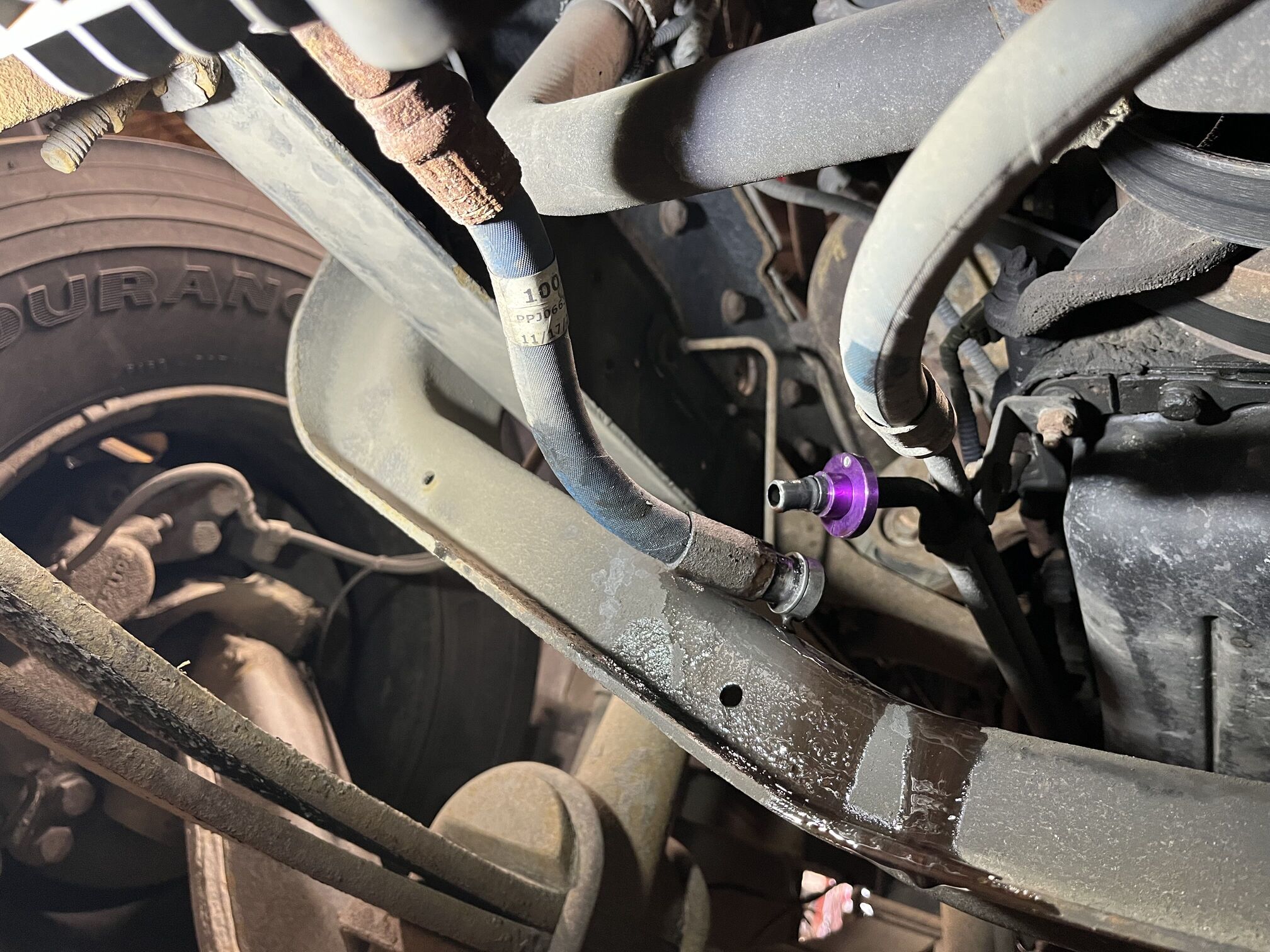

  1. Disconnect the rear of right side transmission cooler line with a 1/2-inch transmission oil cooler disconnect tool for FORD

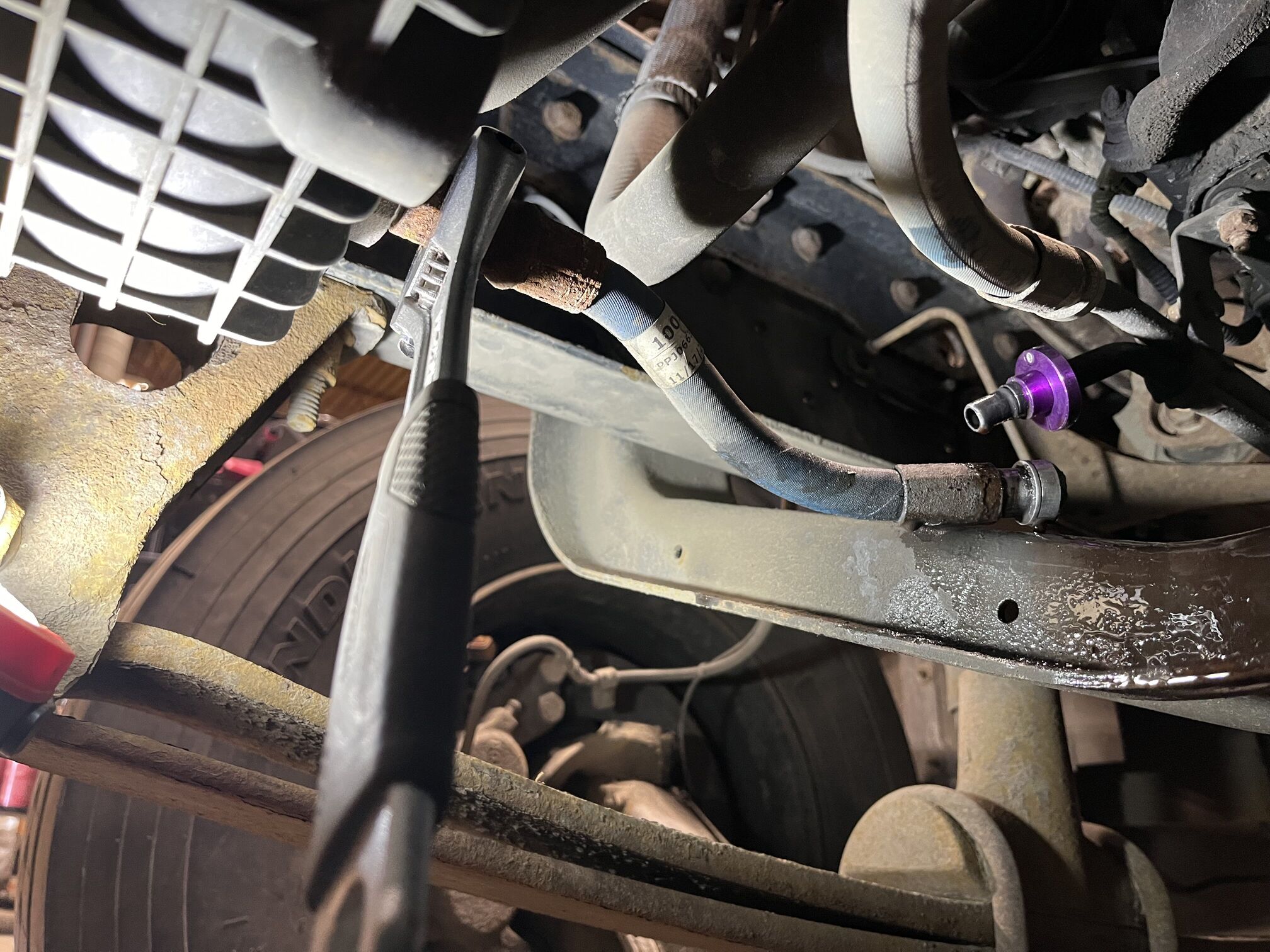

  2. Disconnect the front of right side transmission cooler line with a crescent wrench.

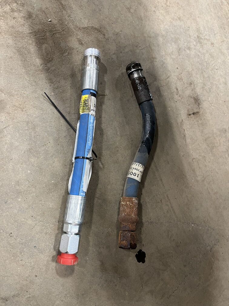

  3. Compare the old parts with new one.

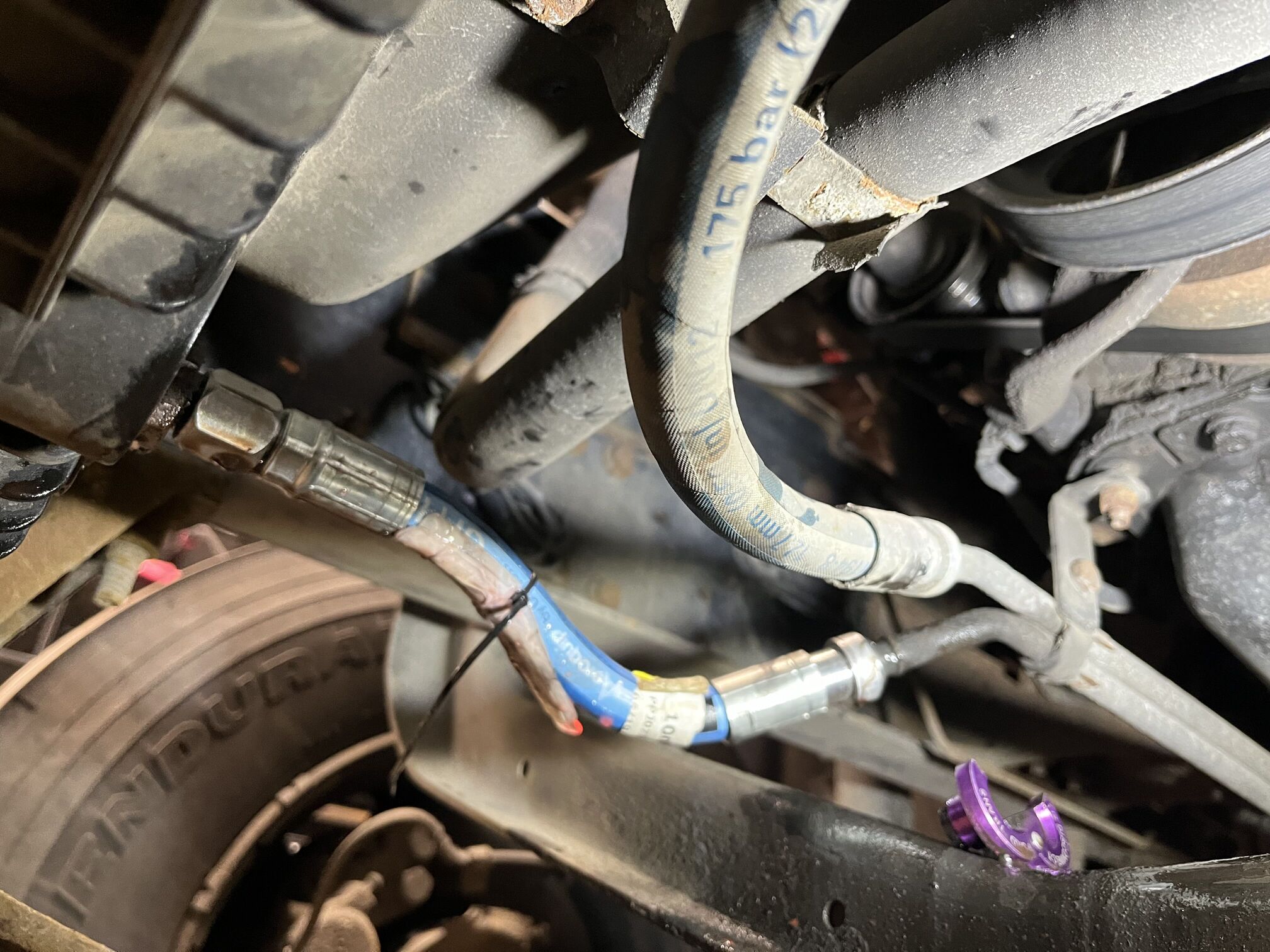

  4. Connect the rear side of transmission cooler line.
  5. Connect the front side of transmission cooler line to the radiator.
Note: Sometimes the connector in the radiator will move together when you remove the front of the trans cooler line, use a big clamp wrench grasp the connector in the radiator, one vise grip grasp the connector of the cooler line. Break loose. Disconnect the front of cooler line. Tight the connector in the radiator with a big clamp or coolant will leak.
