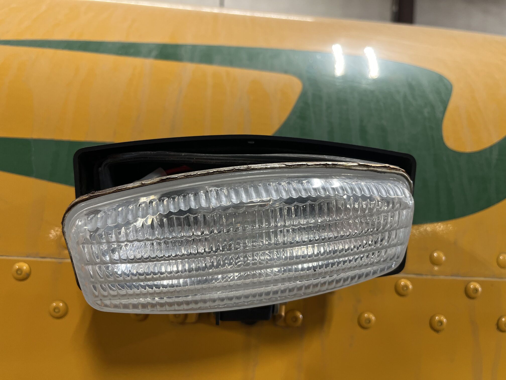

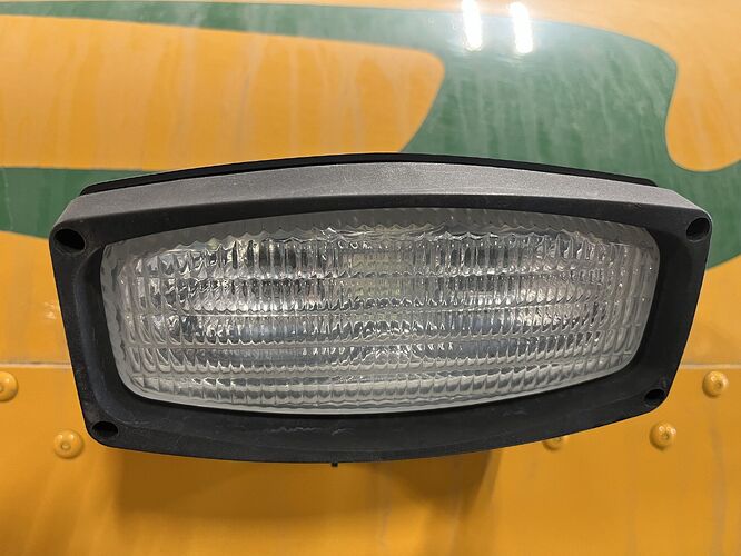

Blue Bird bus porch light front not working

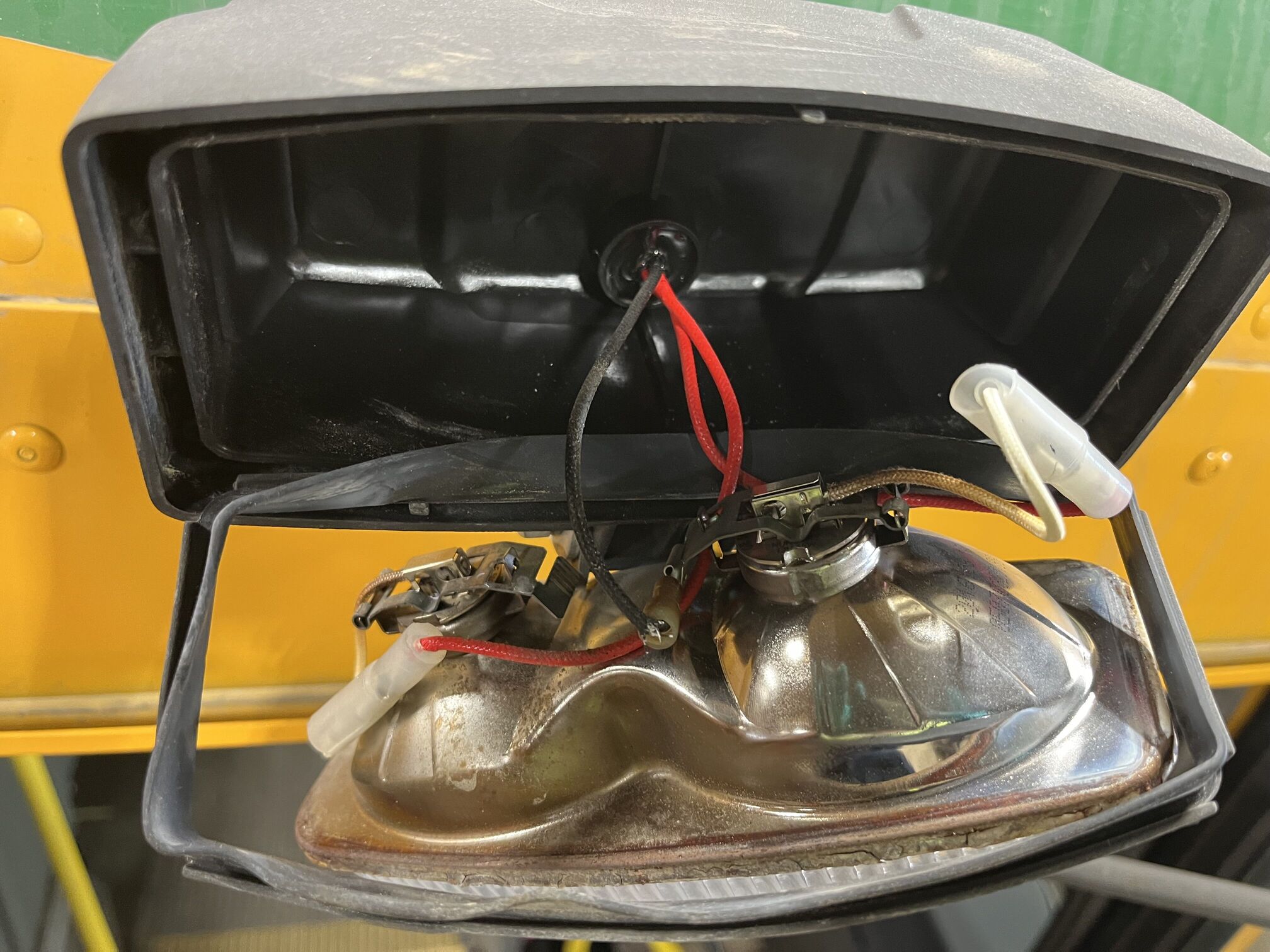

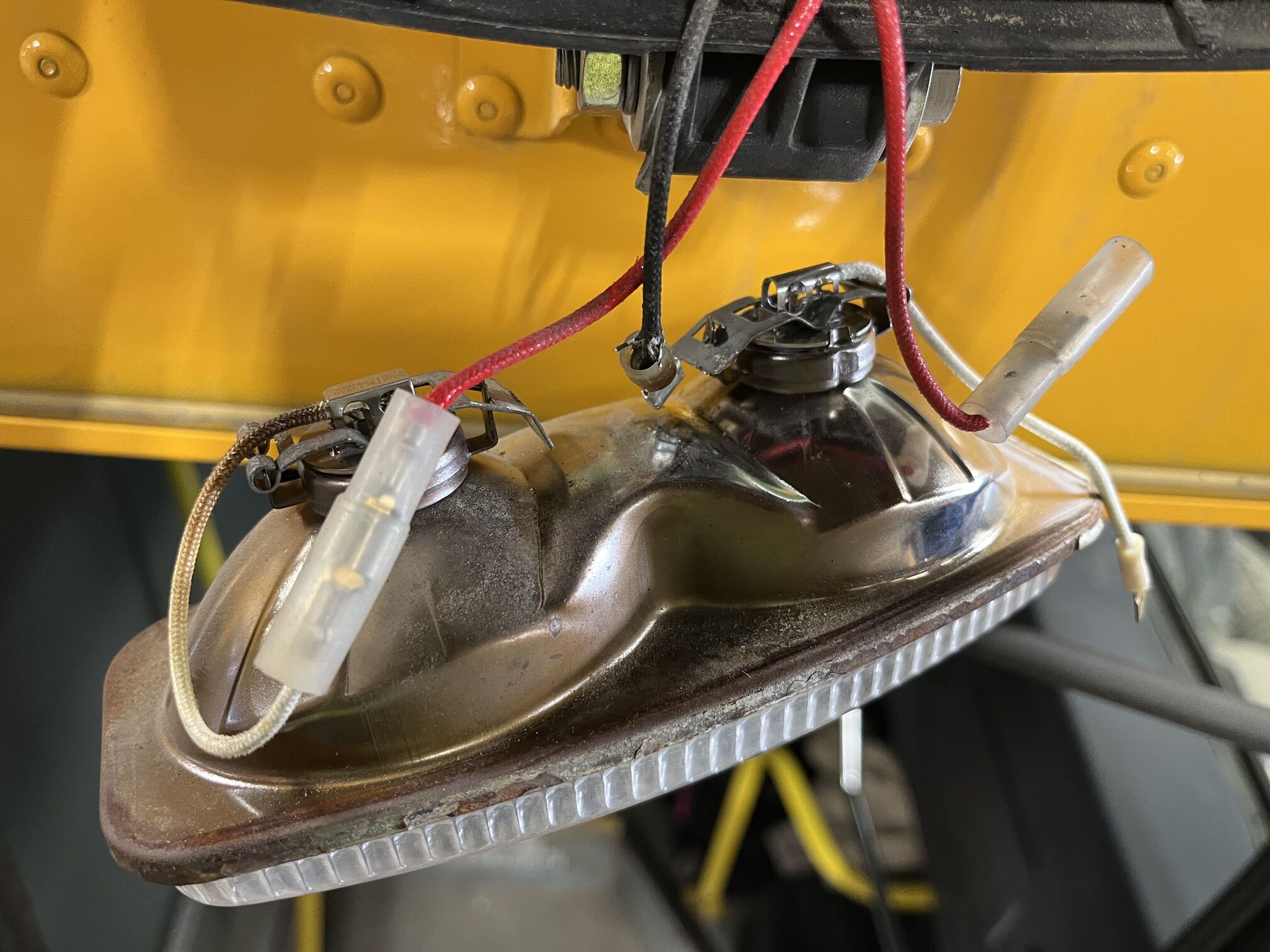

  1. Remove the surround side cover

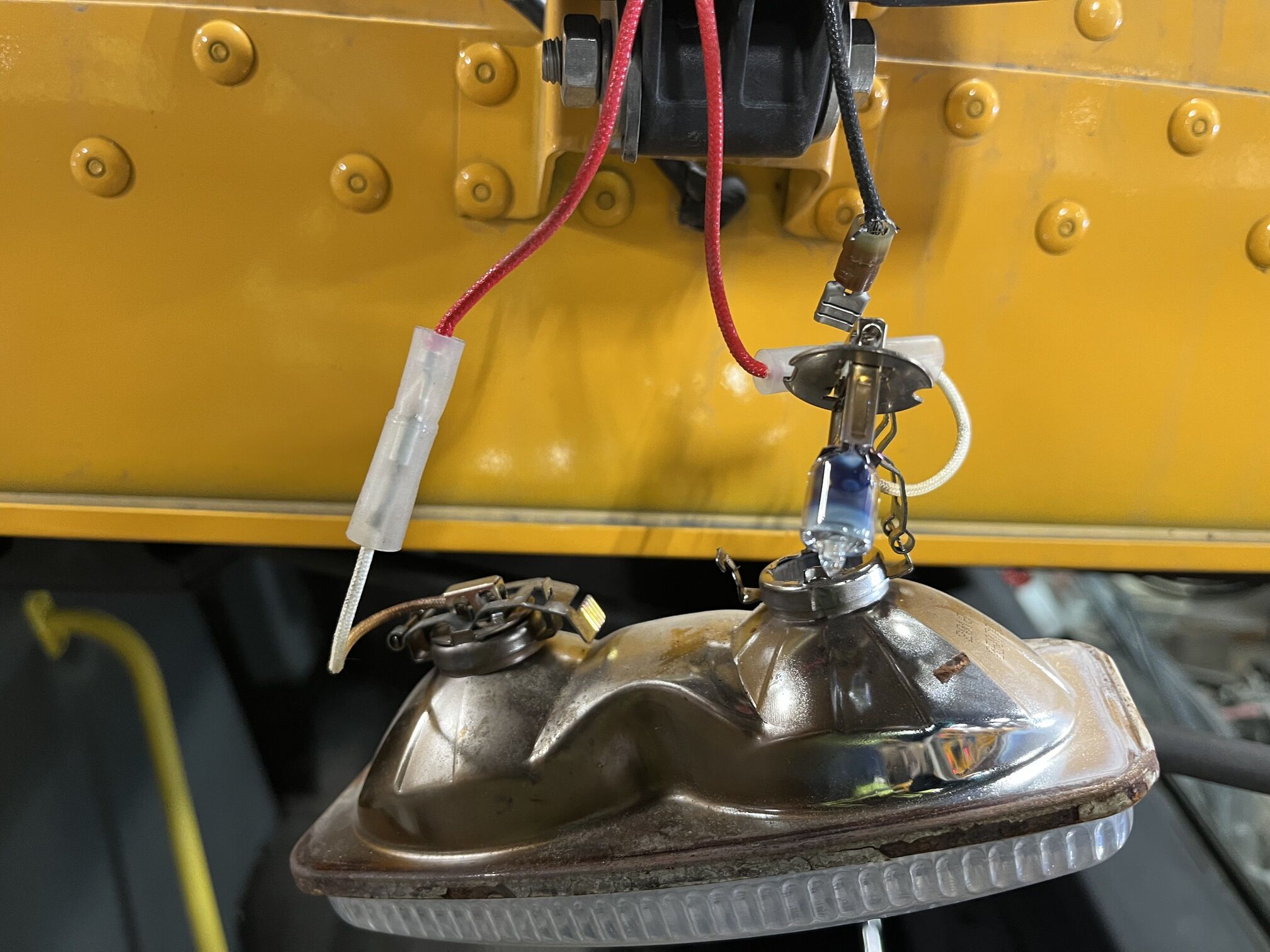

  2. Take out the front bulb. Looks black, damaged

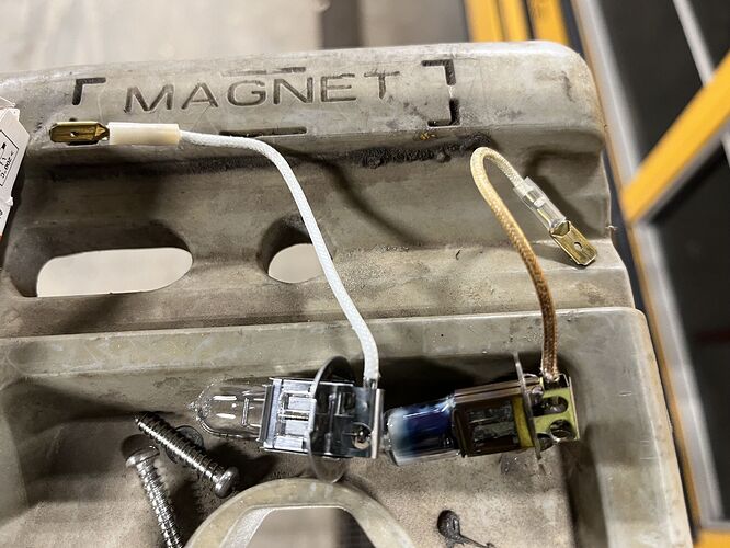

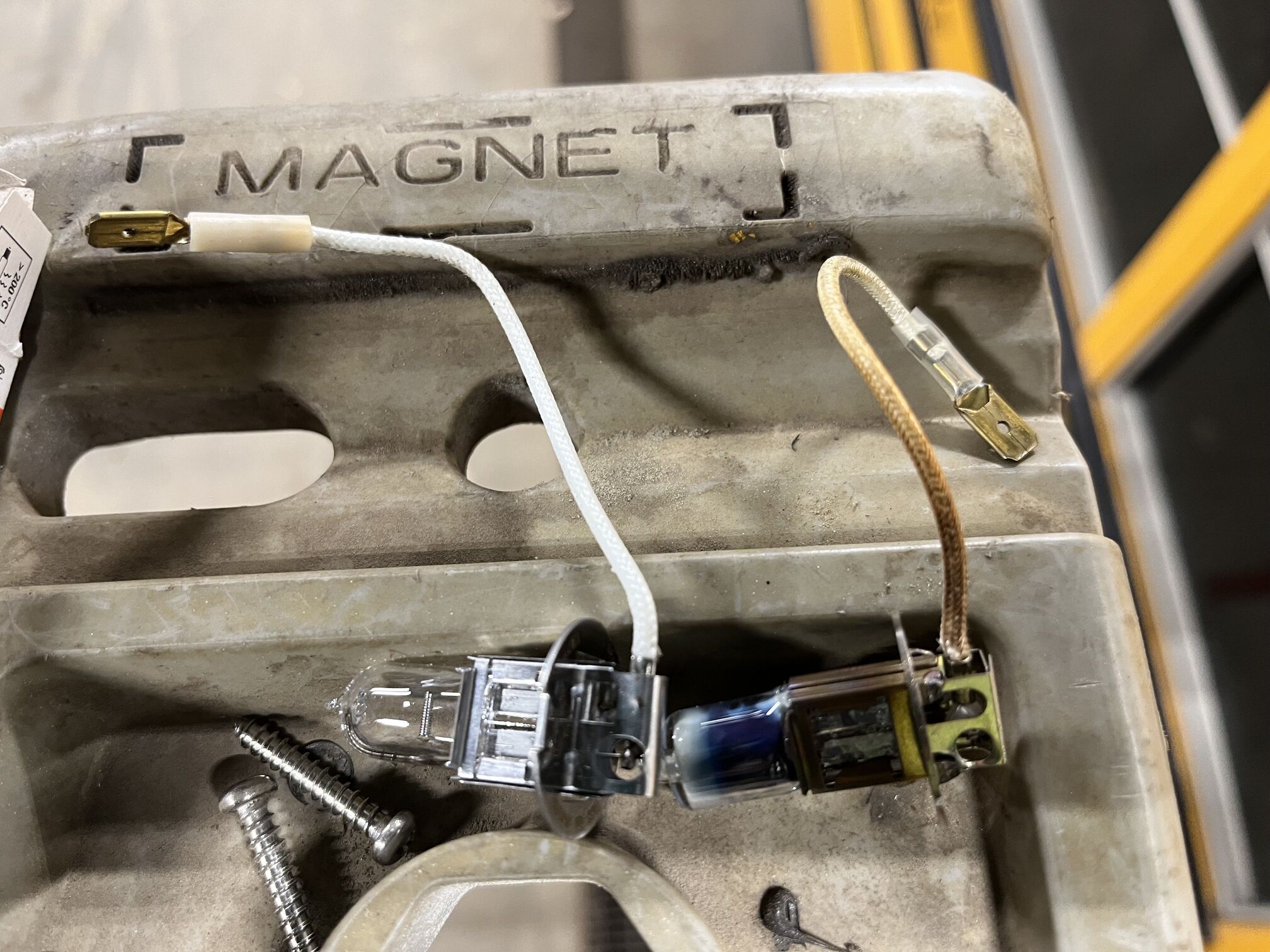

  3. Compare new (left) and old (right)

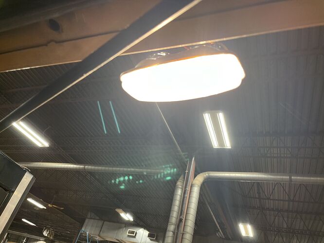

  4. Install new bulb

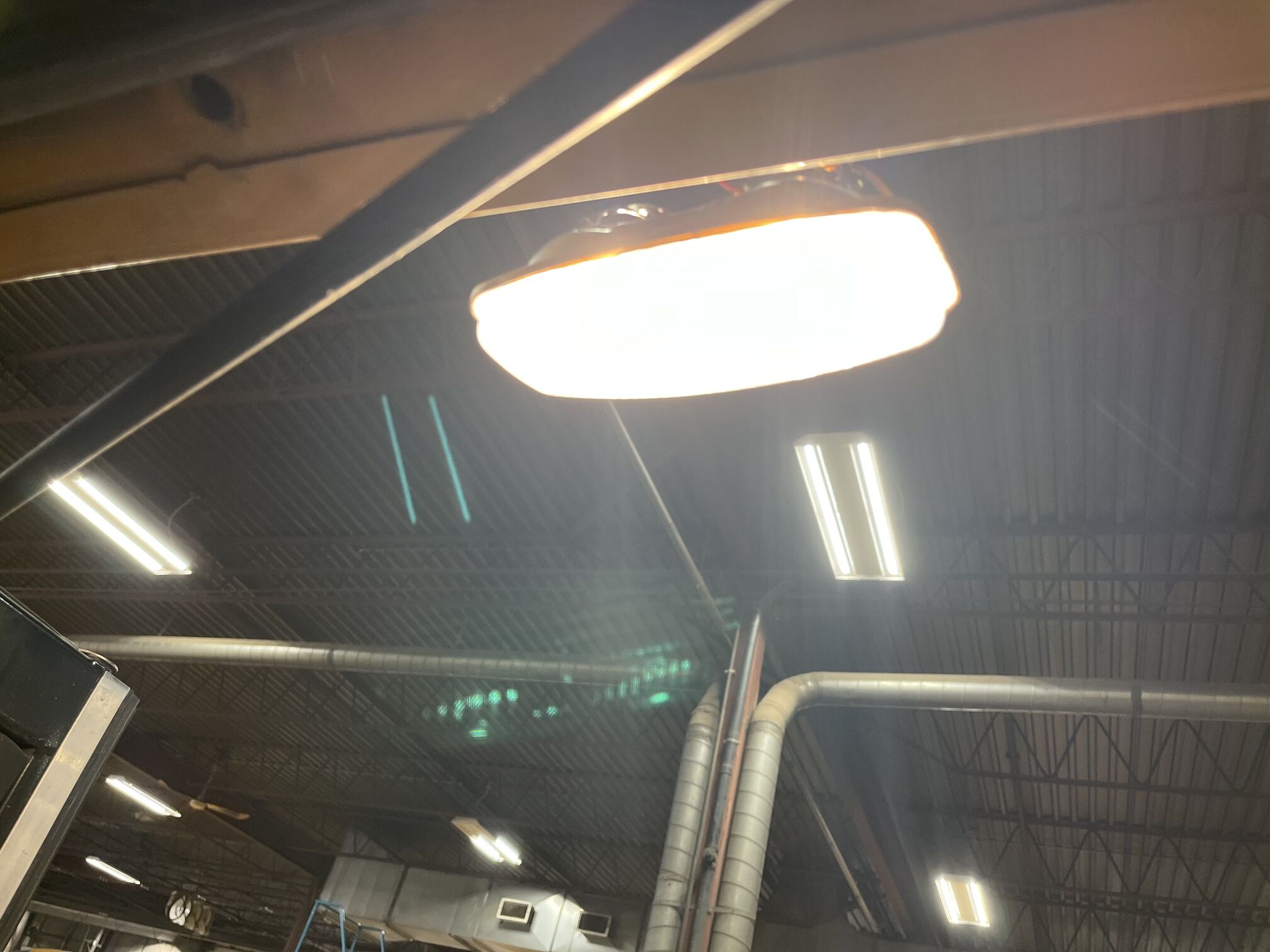

  5. Test
