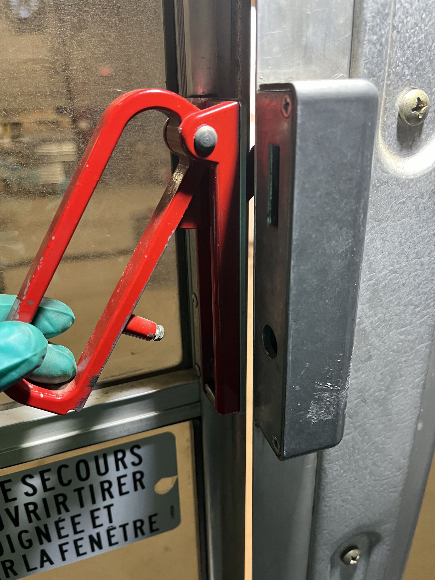

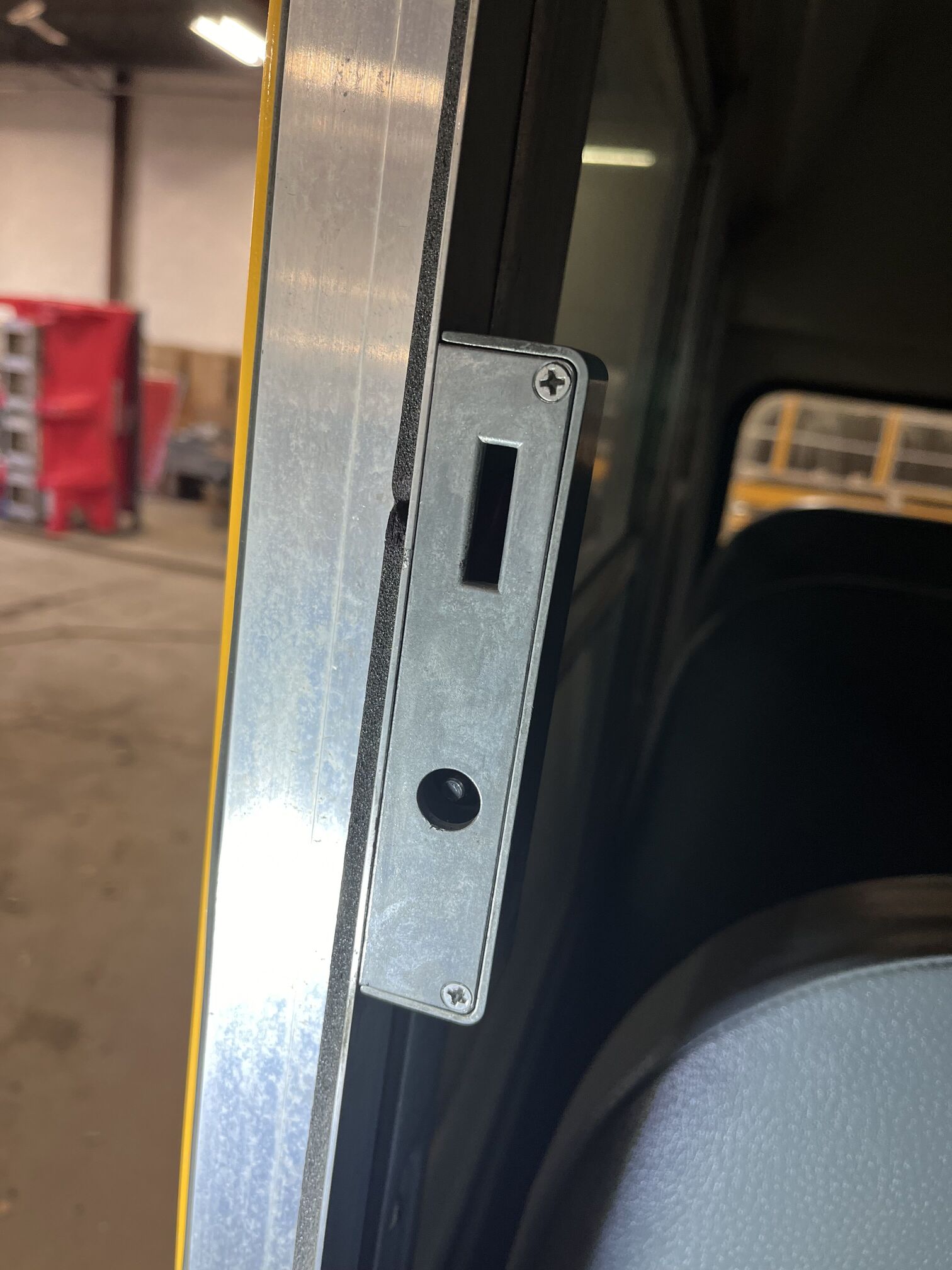

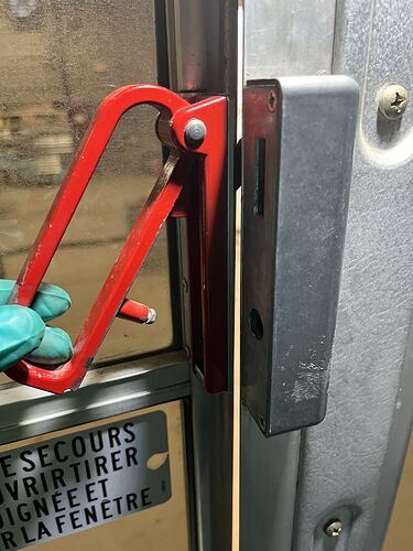

Remove the cover of window alarm sensor
Check the sensor status

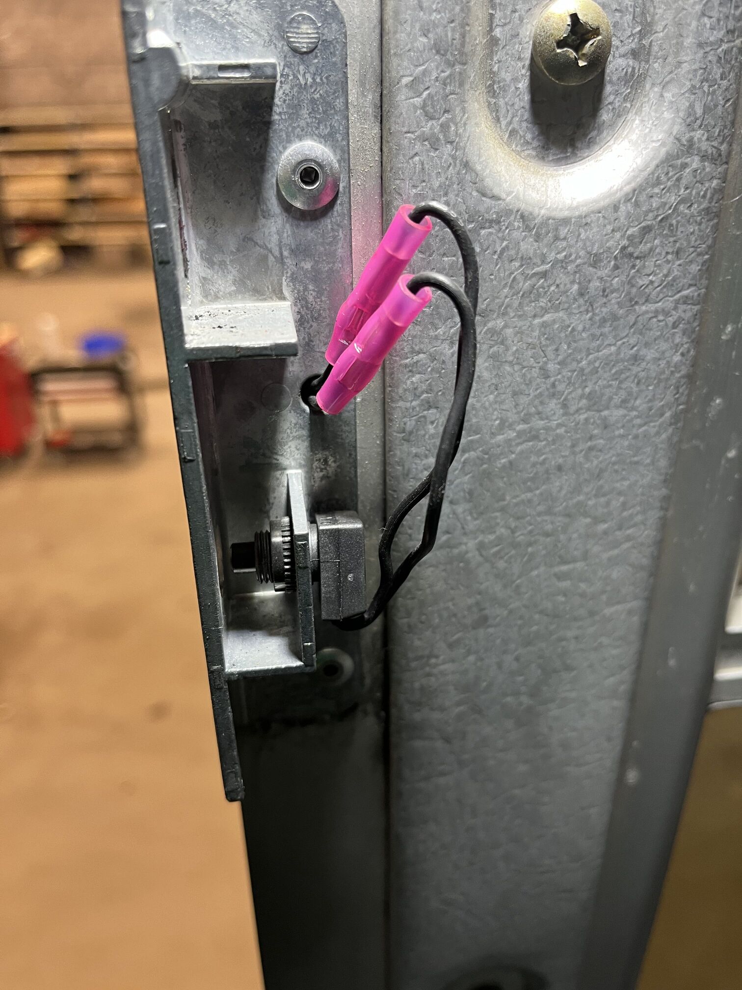

Check the continuity of sensor. Normally close. Sensor switch press down, open. Good sensor switch. -
Check the wire of sensor
Remove the plastic cover on top of the window
Check continuity
The connector is loose. Reconnect them. -
Test good.
