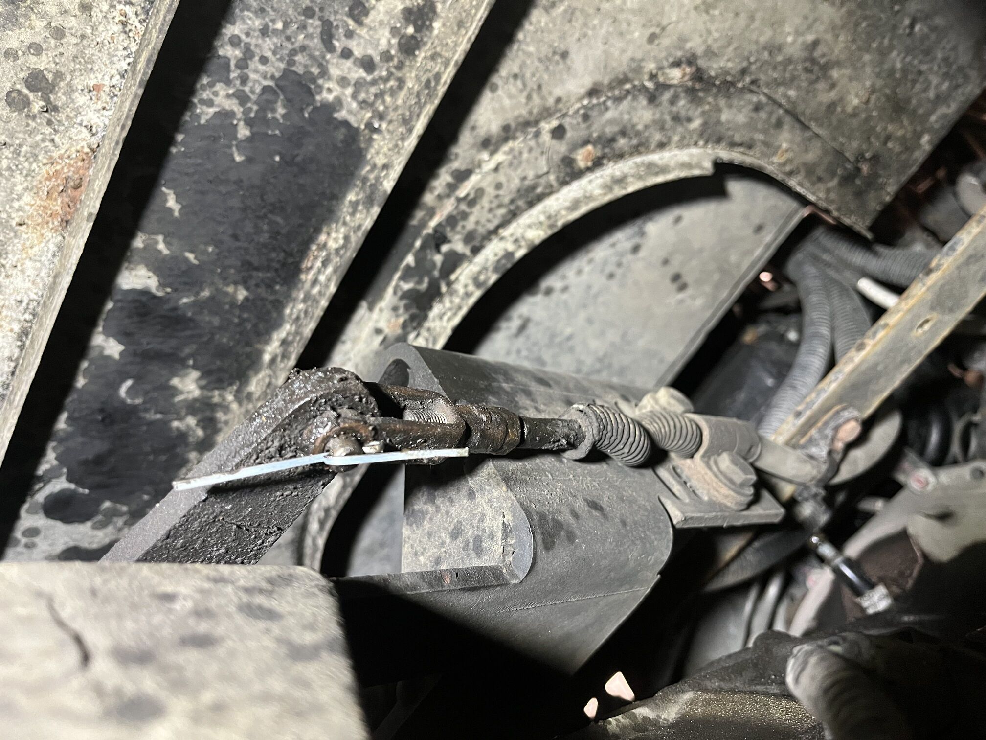

  1. Loose the 13mm lock nut all the way to front.
  2. Remove the cotter pin.
  3. Remove the pin connect to the transmission.
  4. Clockwise the adjuster to the very end.
  5. Reinstall the pin
  6. Put new cotter pin in.

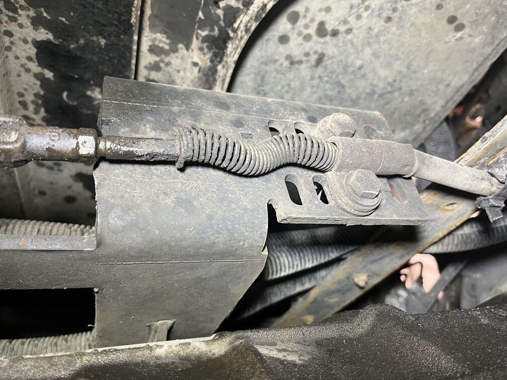

    Note: If the lock nut already all the way to the front. You can also adjust the two bolts, move forward. You need replace parking brake cable if the two bolts already one step near very front. As showing in the following picture.
