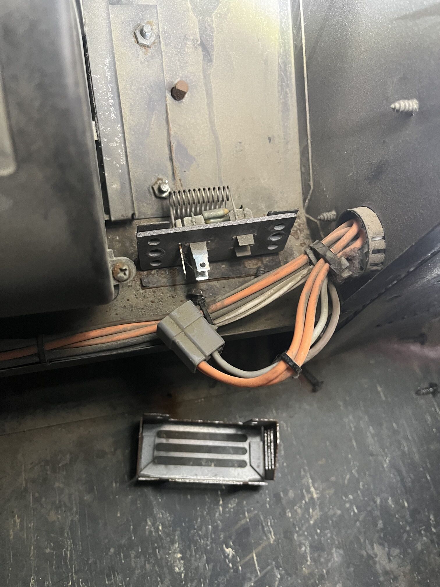

Remove the cover of drive side blower. On the left side the driver seat.

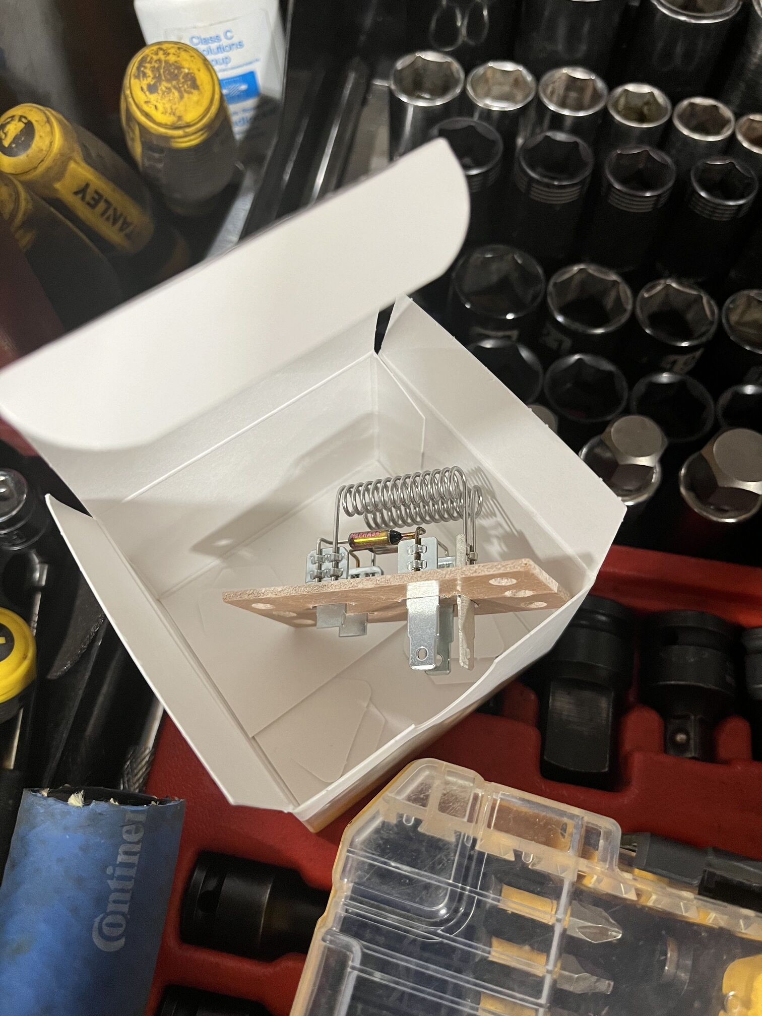

Test the continuity of the resistor. Break in side.

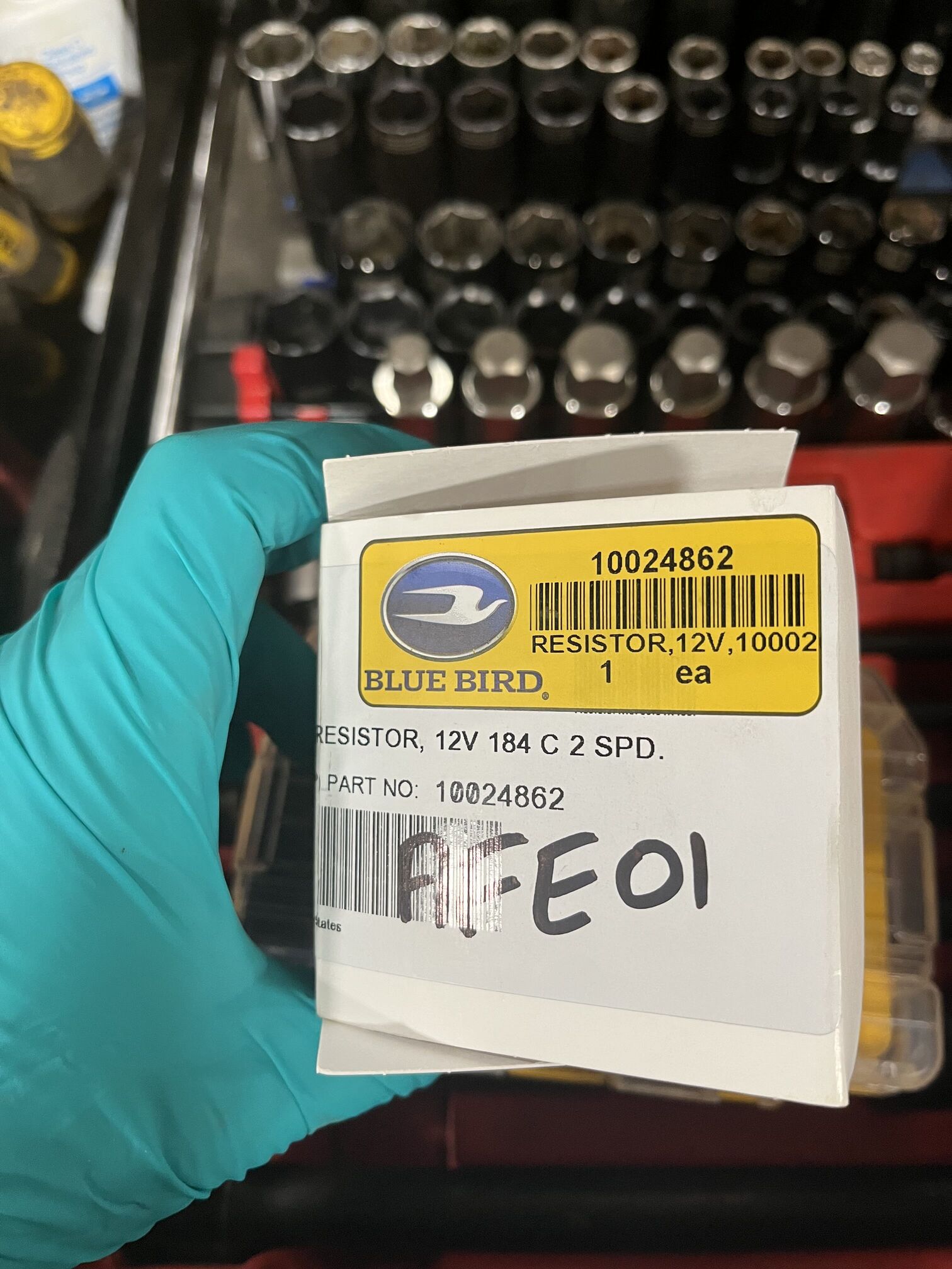

Replace with new one. Part no. 10024862

Reinstall the cover.
