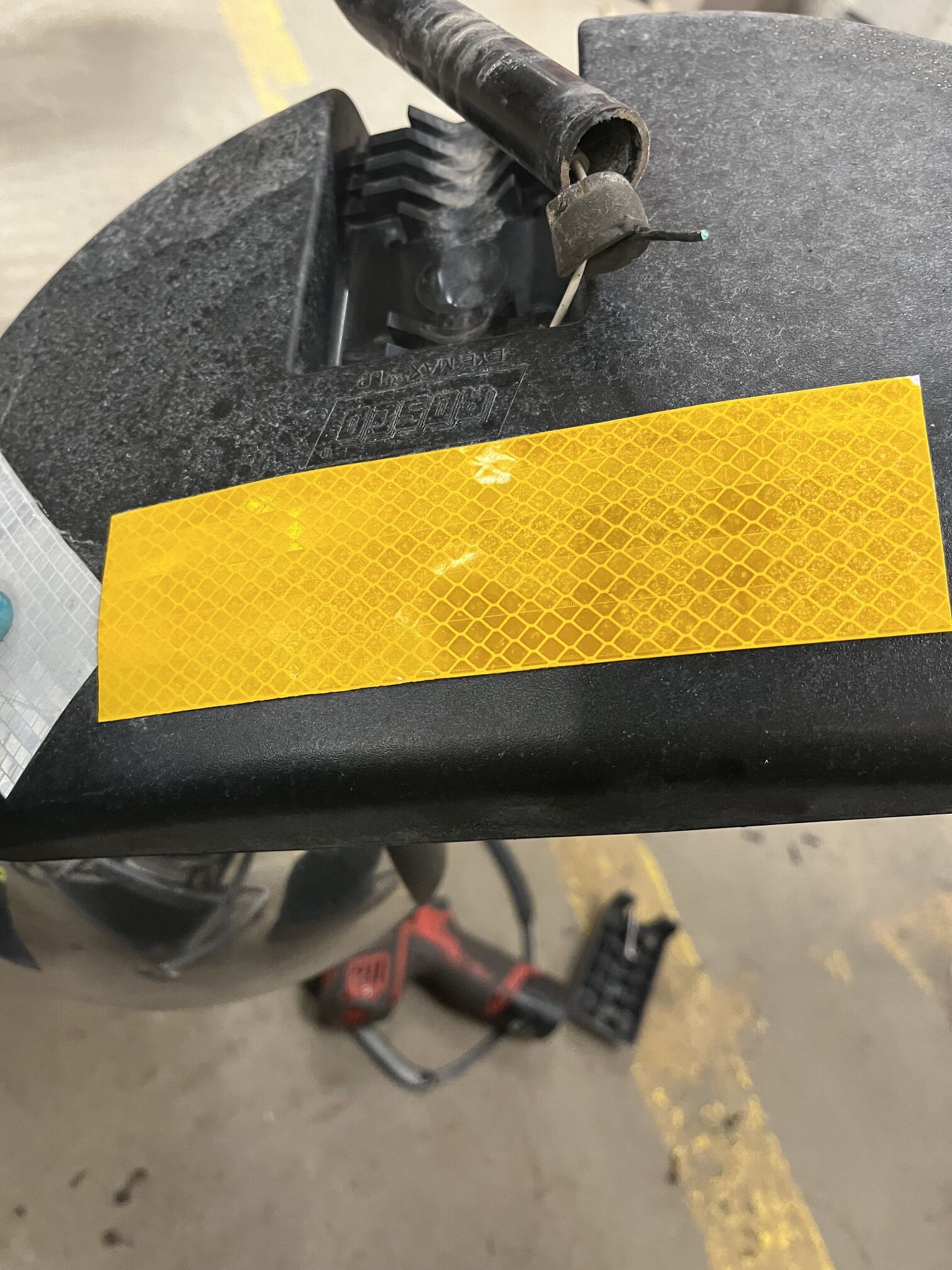

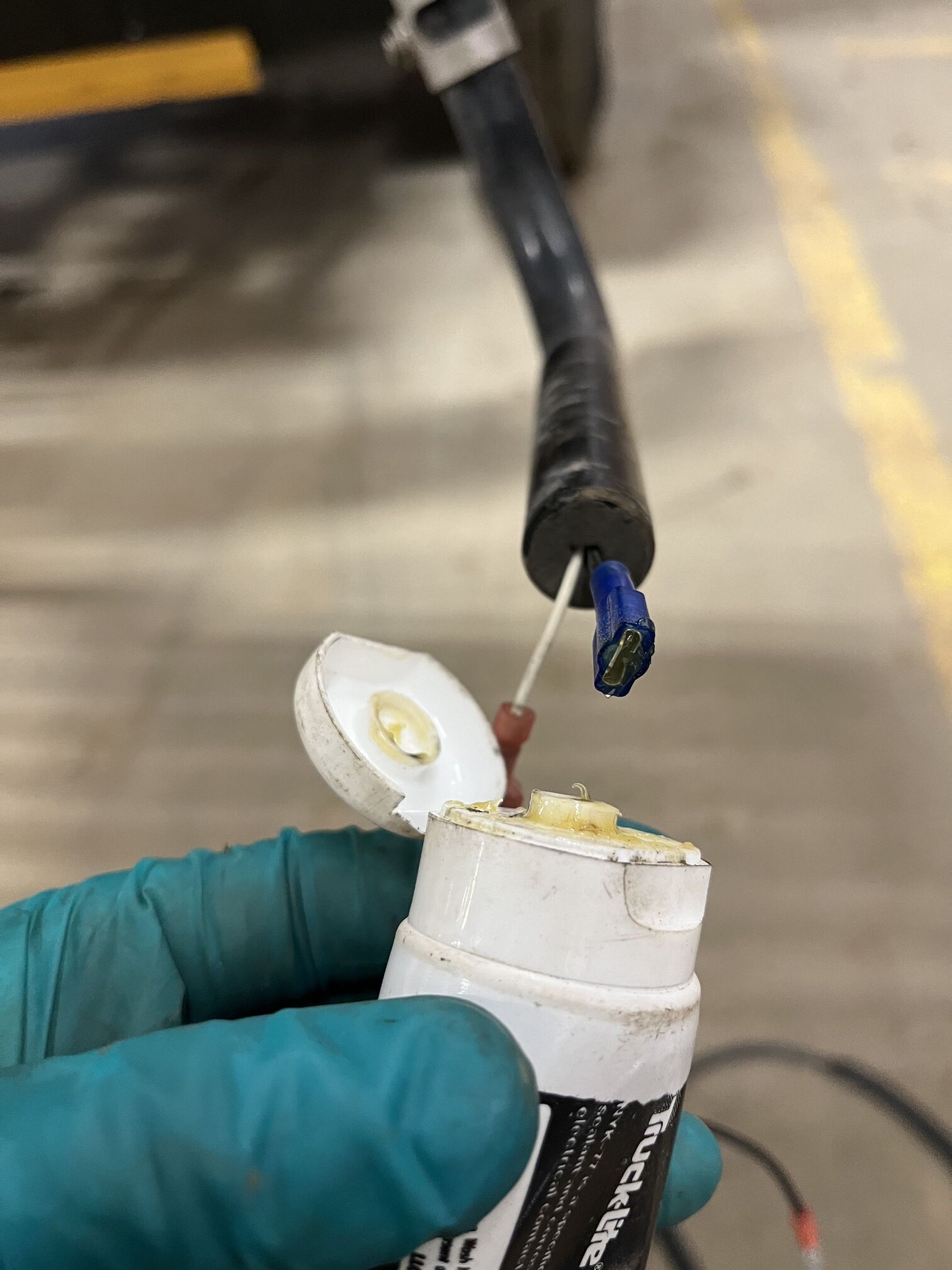

  1. Remove the surround side cover of mirror.

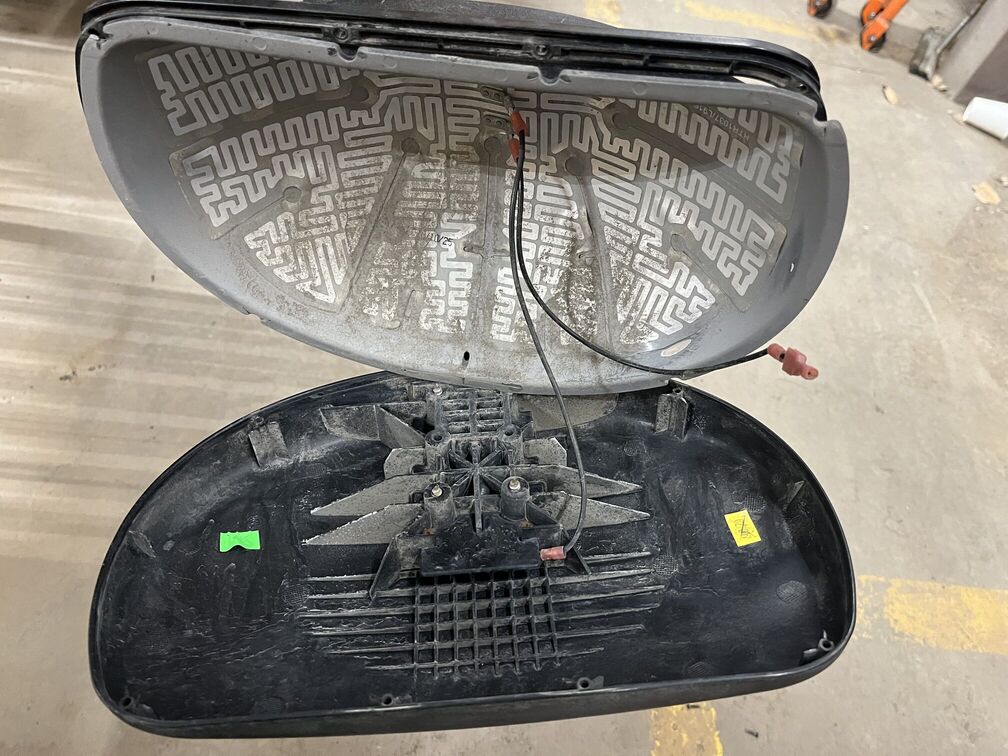

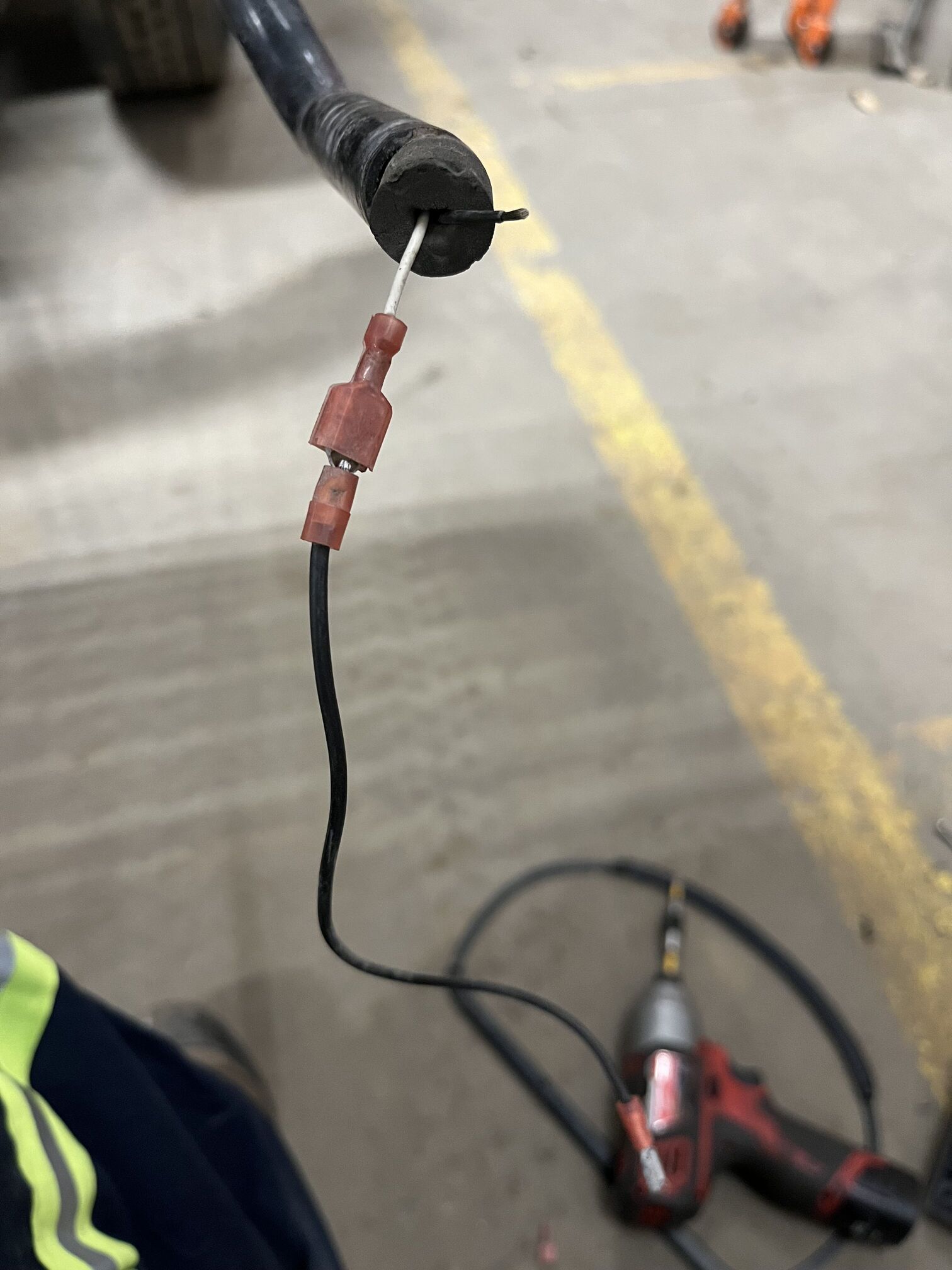

  2. Wire broken in the connector.
  3. Remove the back support, take out the mirror back cover.

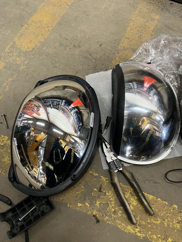

  4. Use a female connector clamp to the broken wire.

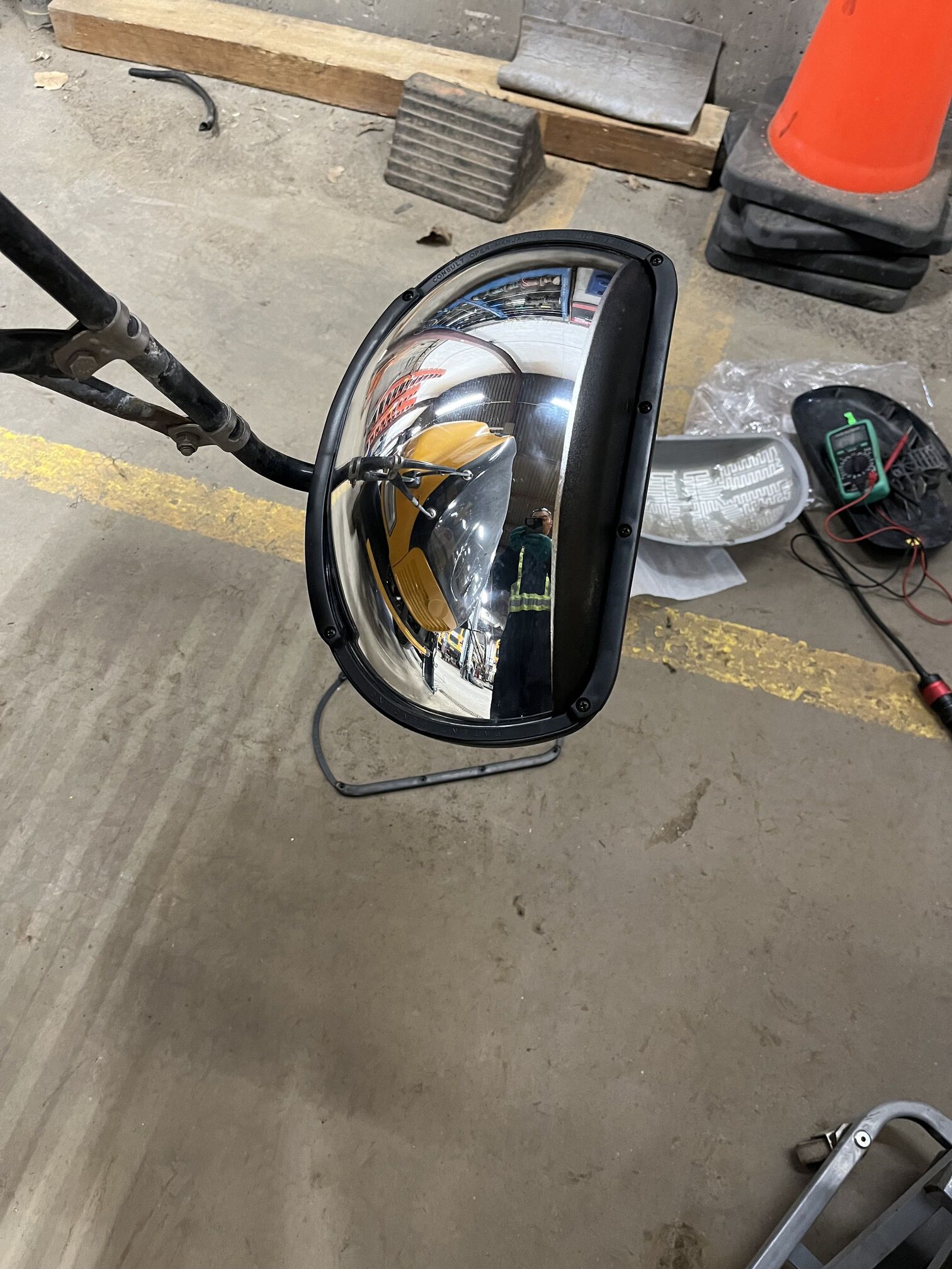

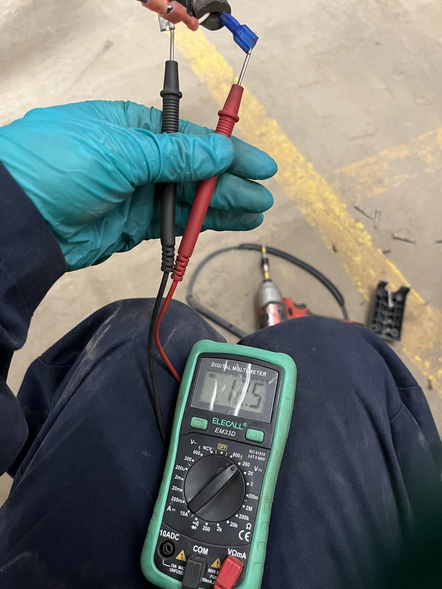

  5. Switch on the heated mirror, check voltage

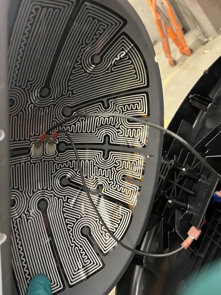

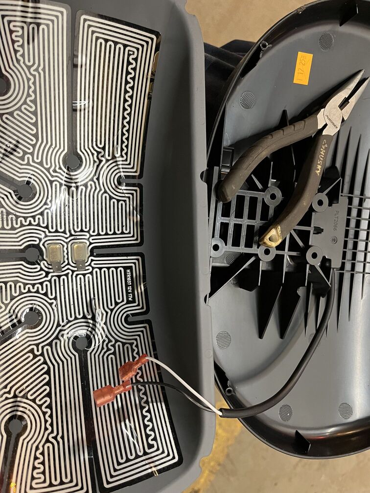

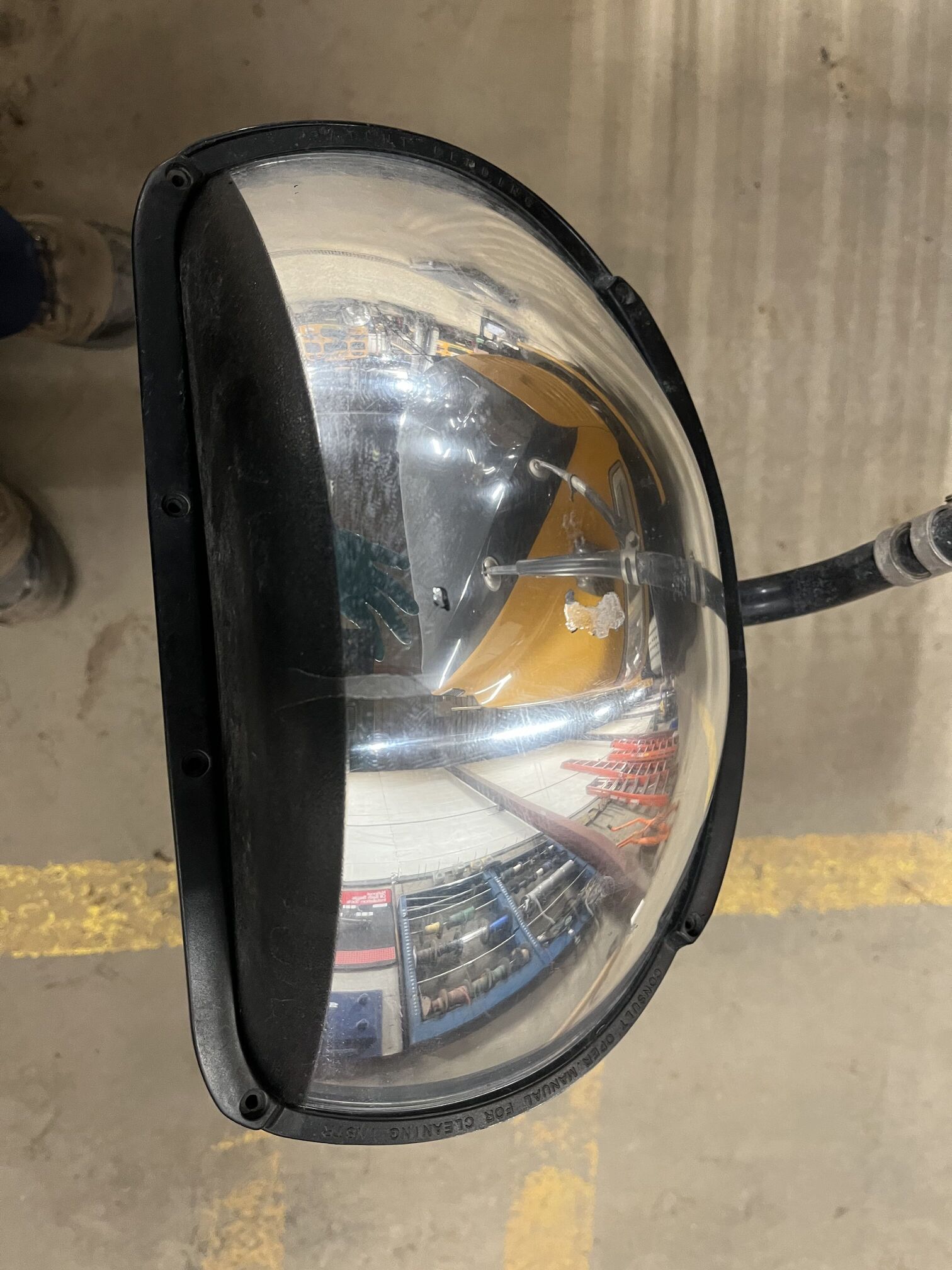

  6. The original mirror worn out, replace with new, compare the new and old
  7. Will reuse the old wire(for there is no same connector of old as new), remove the wire of new mirror
  8. Lubricate the female connector
  9. Connect both wires to new mirror
  10. Install the mirror
  11. Test
