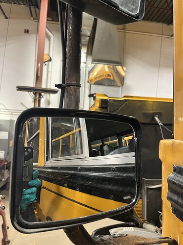

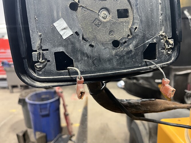

LHS lower convex mirror no heat.
Remove the mirror.

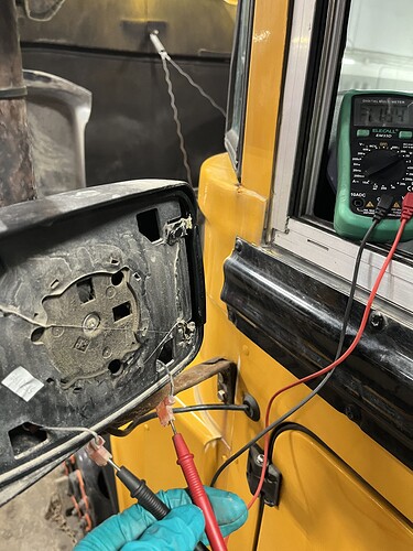

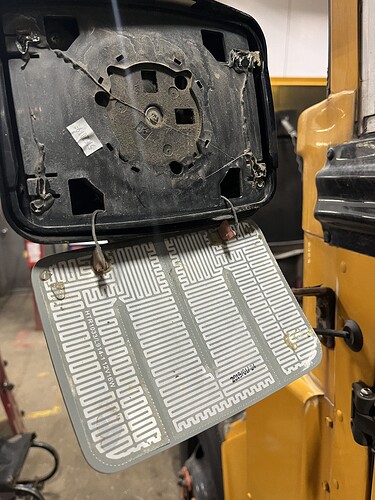

Check continuity. Use a multimeter, no good. Wire broken inside.
Clean the connect tip, use a small file.

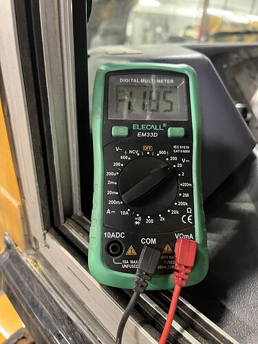

Heated mirror switch on. Check the voltage between the two connector. 11.85. Good.

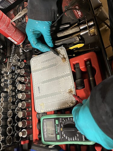

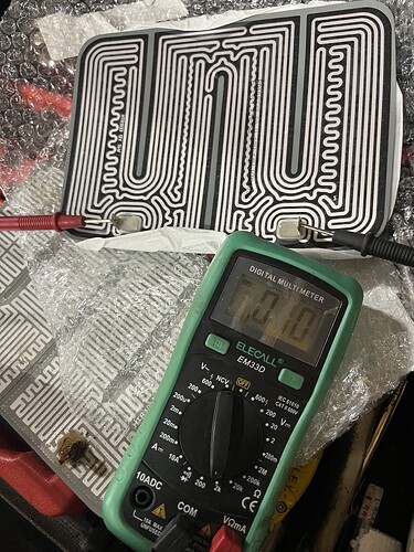

Check the continuity of the new mirror. Good.

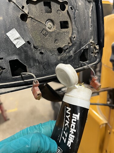

Lubricate the connector tips.
Reinstall the new mirror.
Test. Heated mirror switch on, has heat.
