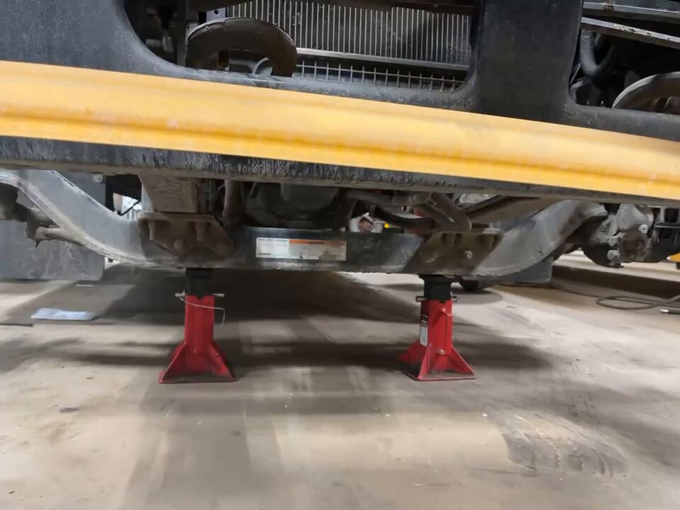

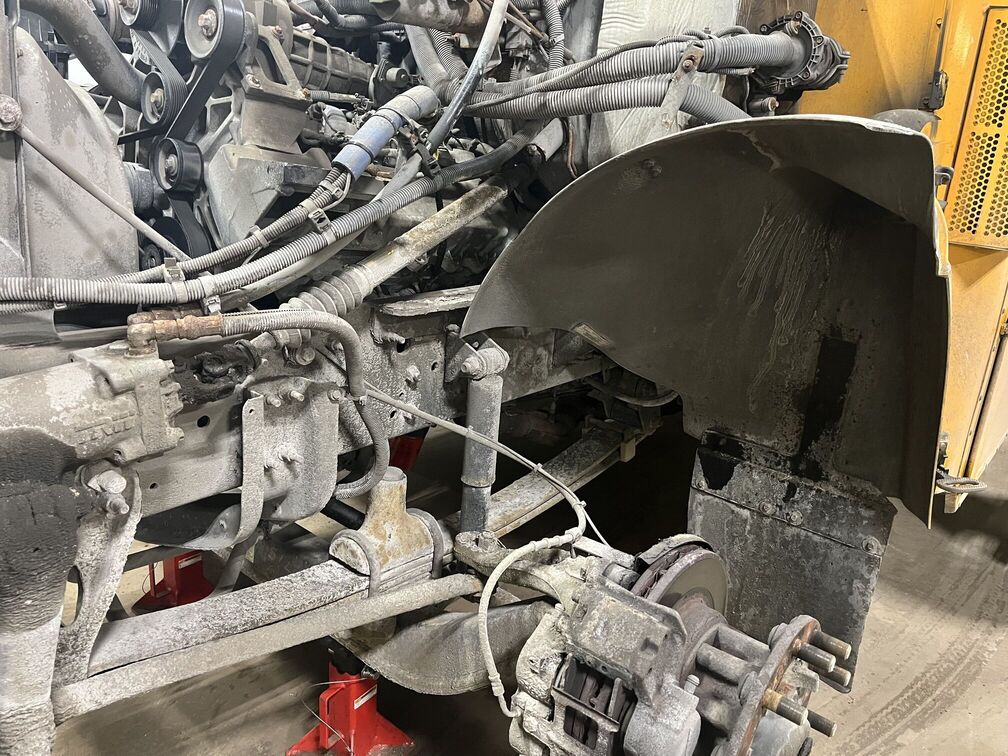

  1. Jack the front frame of bus

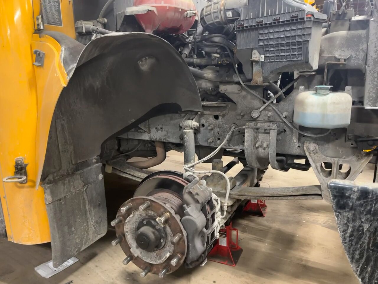

  2. Remove front wheels
  3. Remove front fender(both sides).

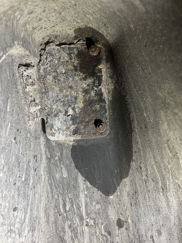

    Usually the top 2 nuts mounting the fender rust out, need to cut out
    The bottom 4 nuts always rust out too, can use a vise grip to grasp the back side. All the nuts are 13mm.

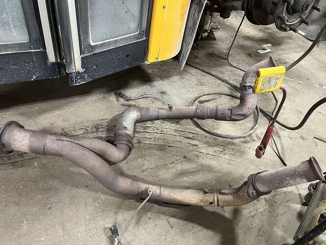

  4. Remove exhaust Y pipe
    Disconnect the top two oxygen sensors, one each side.

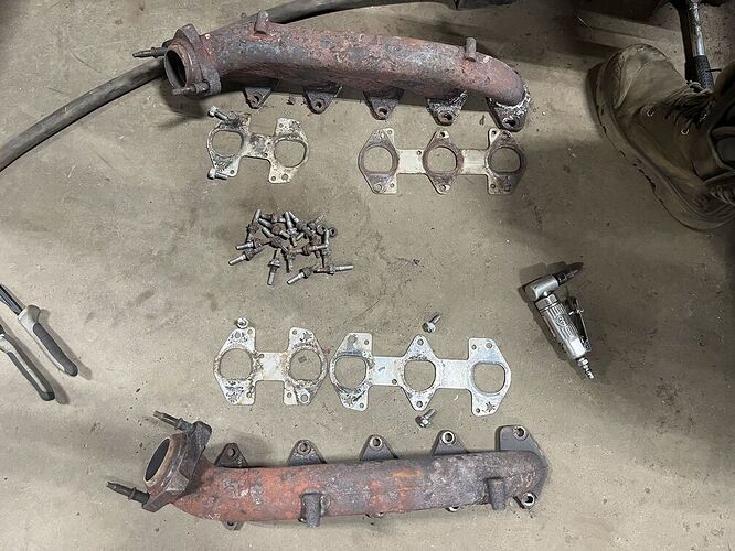

  5. Remove both sides manifold

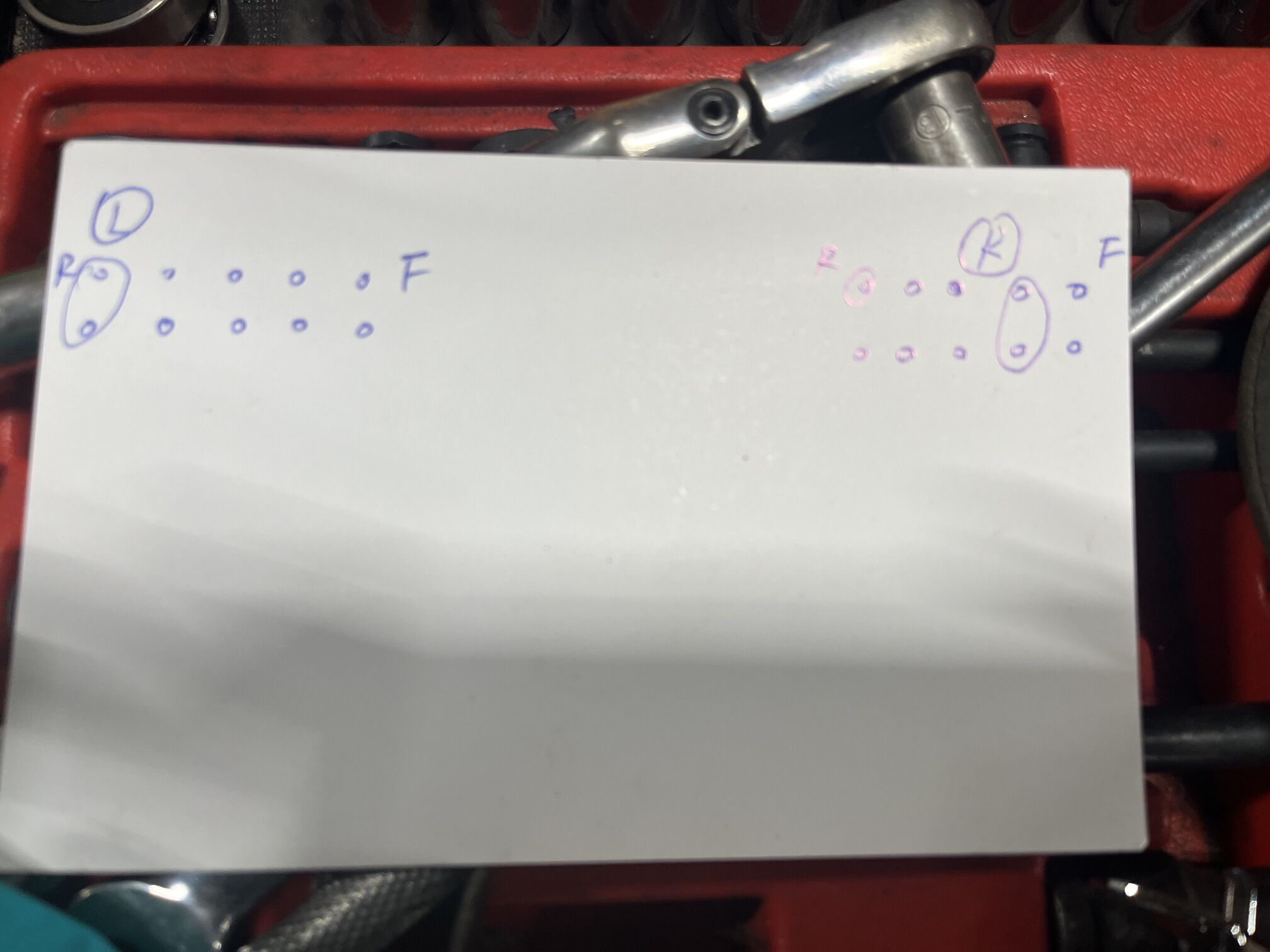

    13mm nut hold stud, 10 on each side, 5 on top, 5 on bottom. Totally 20 studs and nuts on both sides. Usually, studs will come out together when you remove the nuts.
    Remain one stud with nut on the top, just break it loose. It will hold the manifold.
    The middle one on bottom is a little bit difficult to remove for the space is very limit. It is just above the frame. Some techs remove the aluminum shield underneath for more space.

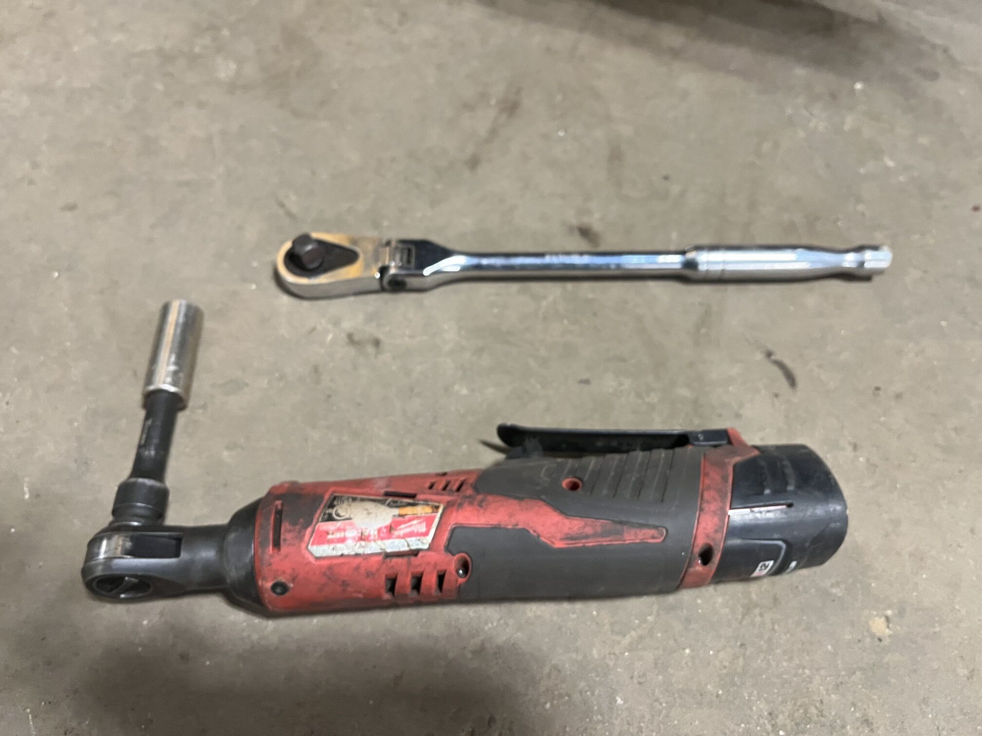

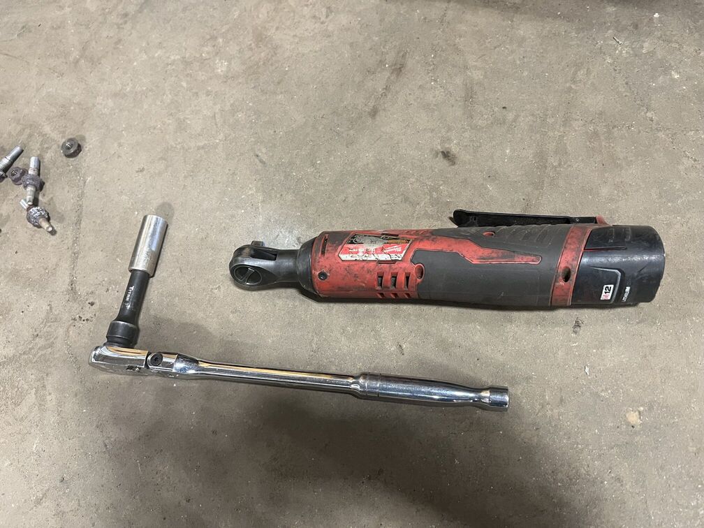

    Trick: Use a 3/8-inch rachet + 3-inch extender + 13mm socket break loose
    Then use a 3/8-inch electric rachet + 3-inch extender + 13mm socket remove the stud.

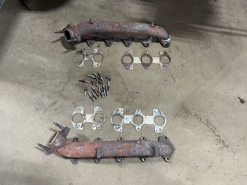

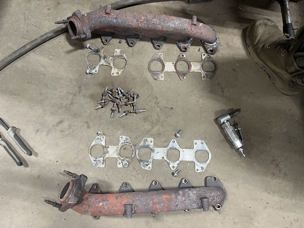

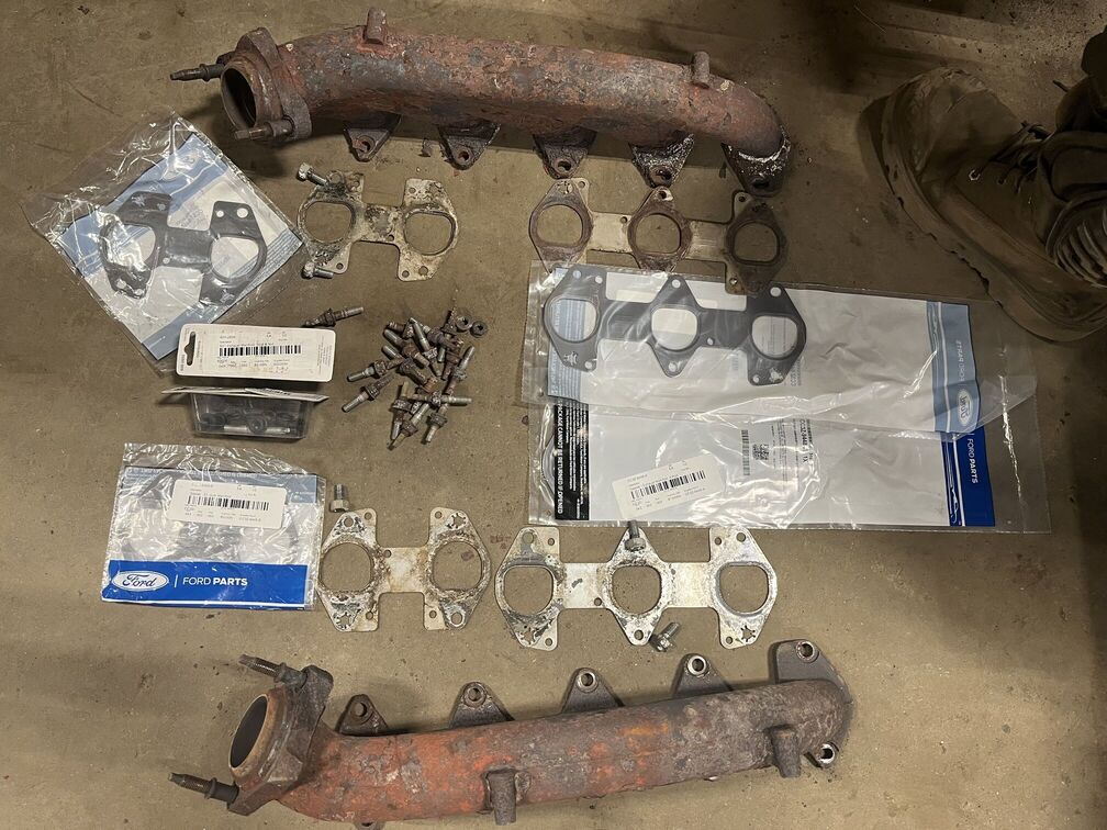

    This case broken 5 studs. 2 on left side, 3 on right side.
  6. Welding out the broken studs
  7. Install new studs on both sides. Put antiseize on the threads.
  8. Install new gaskets on both sides
  9. Clean the surface of the manifold
  10. Reinstall manifold on both sides
