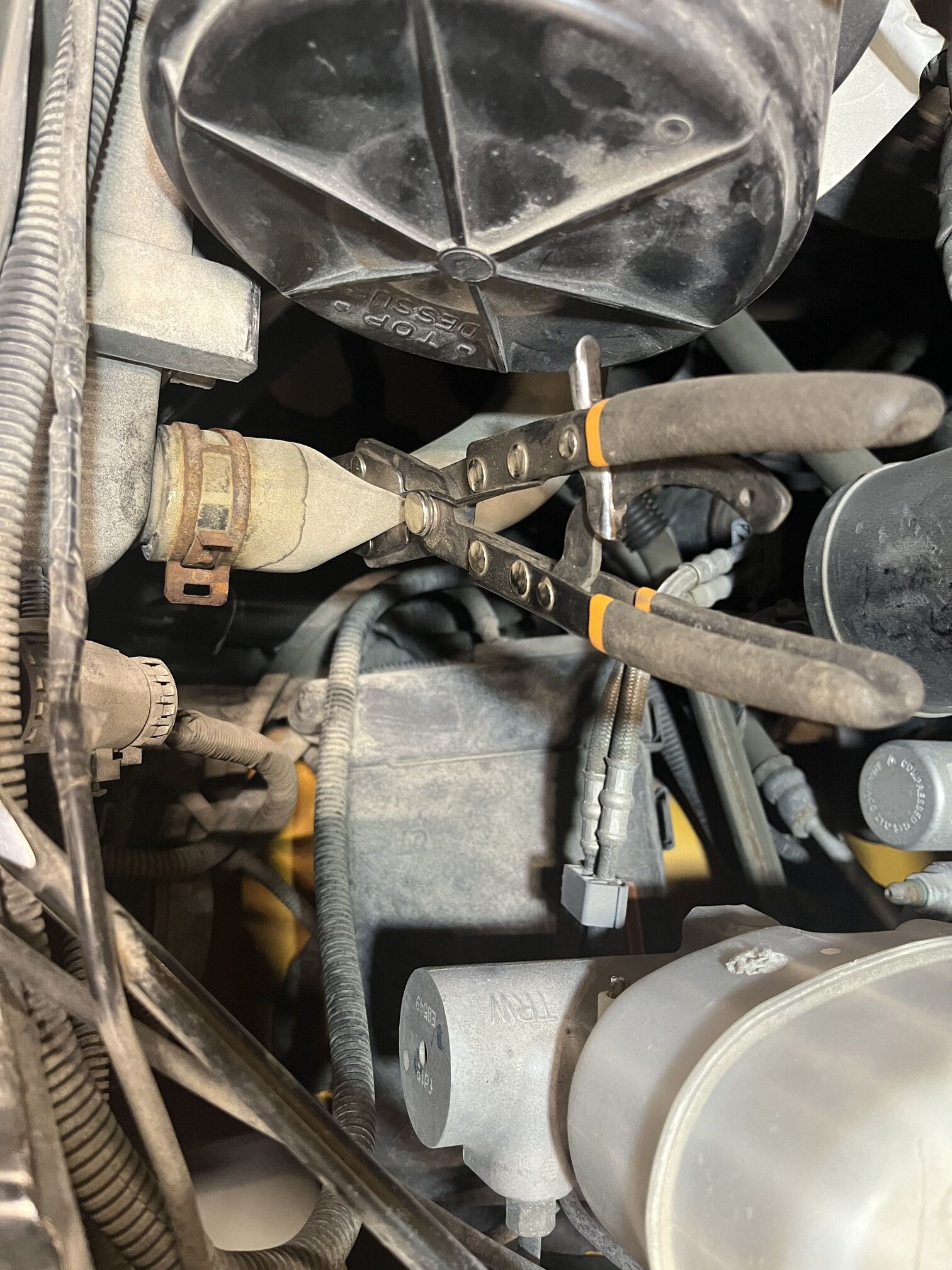

- Remove the spring clips of upside and downside using a small hook pick

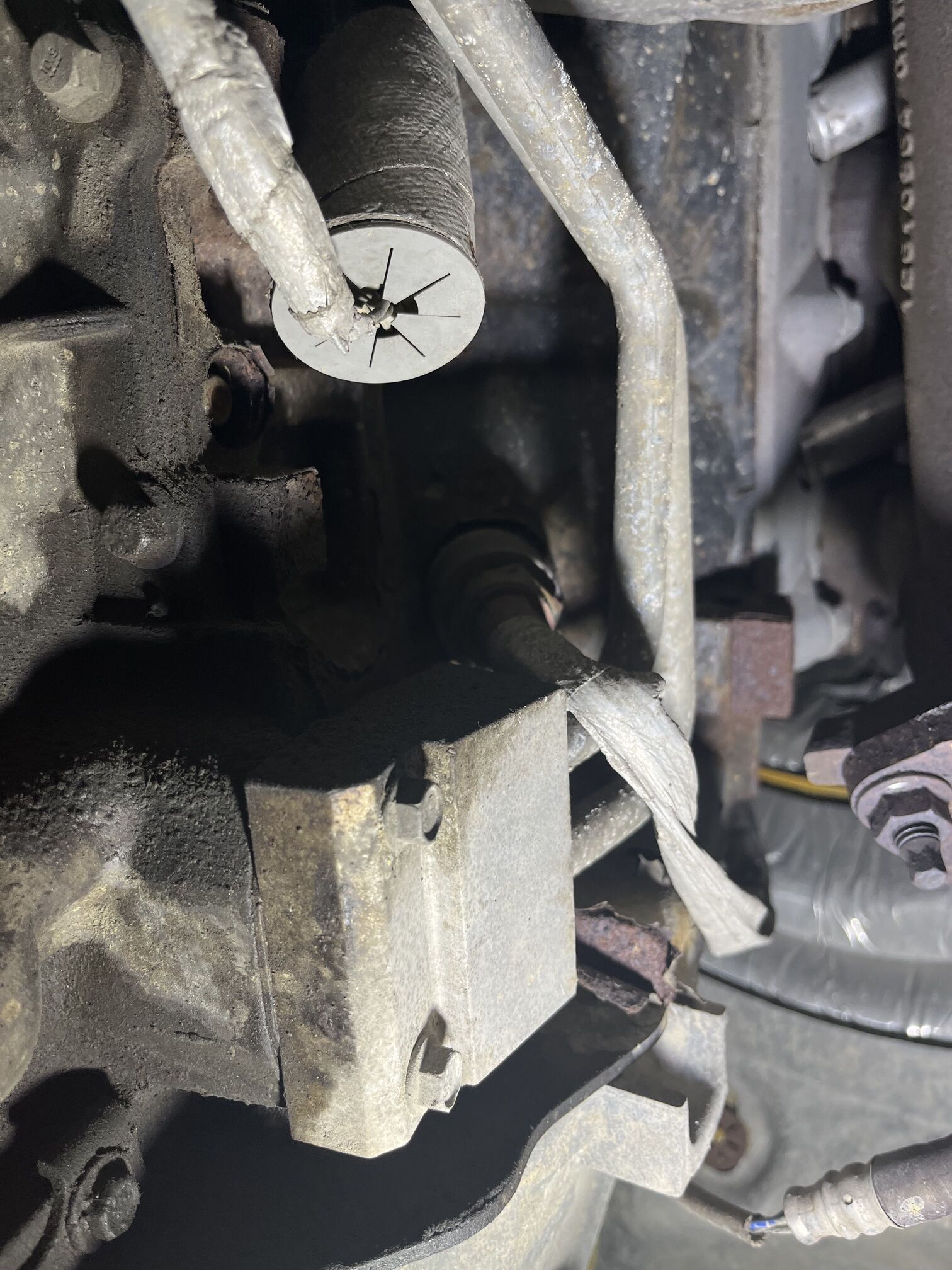

- Remove the bracket underneath near the transmission

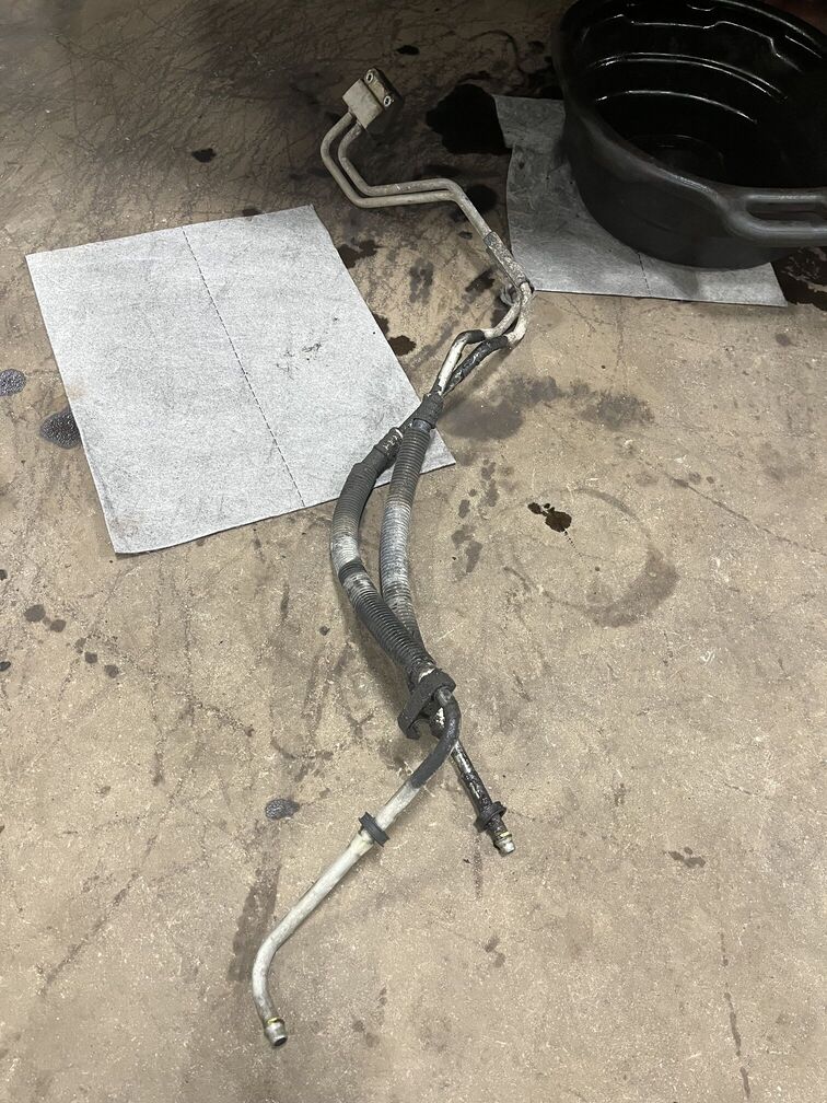

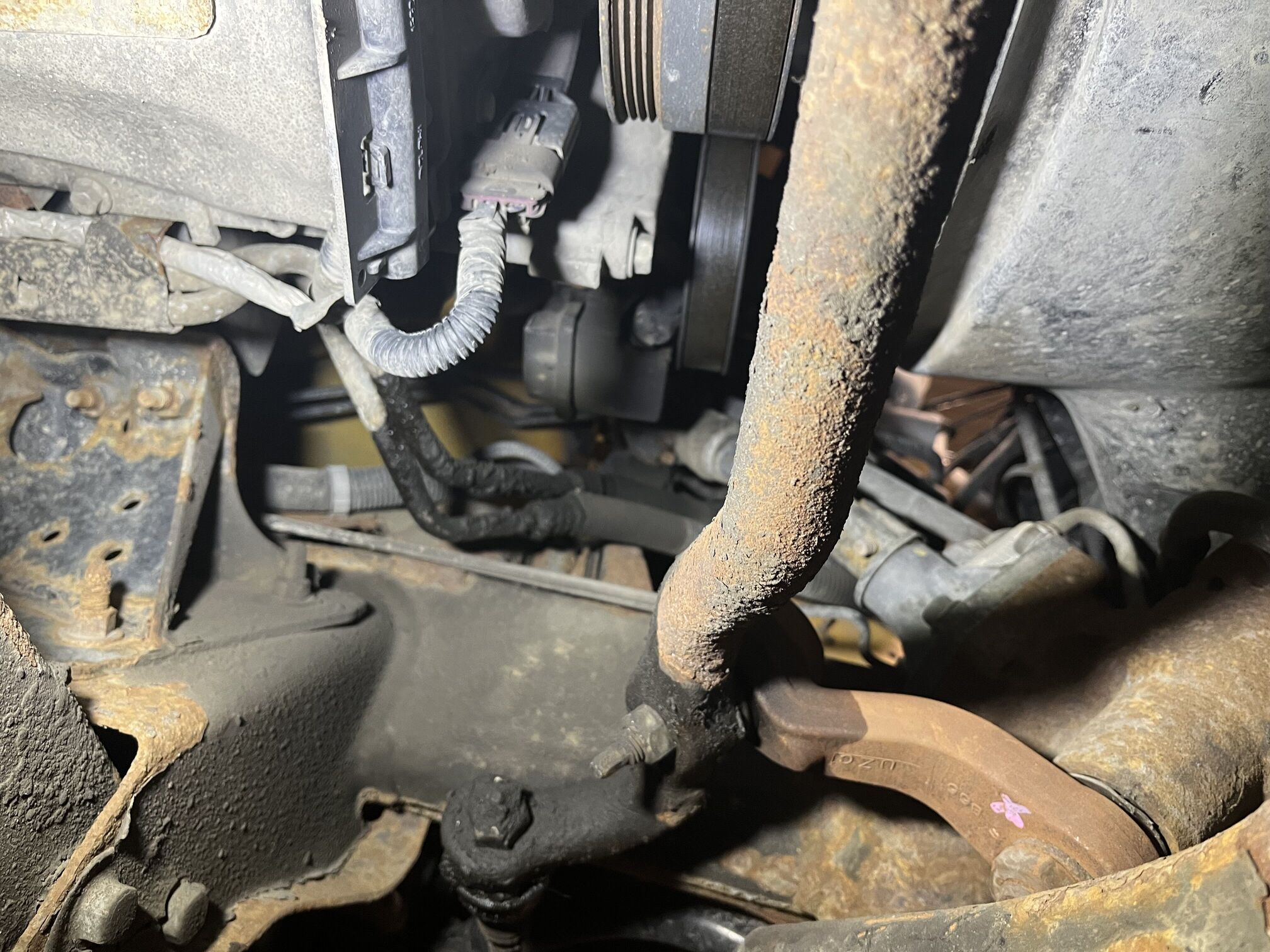

- Remove the in and out tube assembly connect to the trans
- Compare the new and old trans cooler line

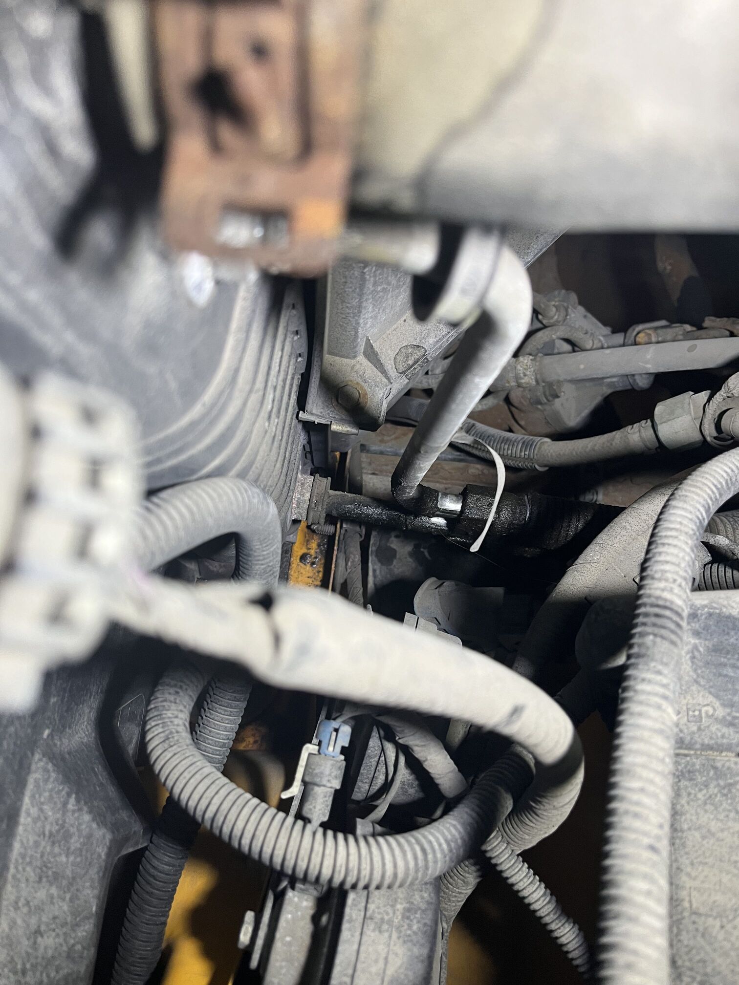

- Set the cooler line in the right position from underneath to top
- Screw the bracket underneath near the trans
- Screw the in and out assembly connect to the trans
